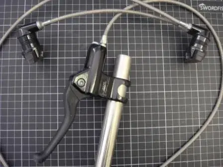

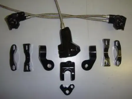

The magura's came back from the powder coaters months ago and it was a disaster.
I sent them down as a sealed unit thinking the temperature would not be a great problem.
Big mistake. There are plastic seals around the master and slave cylinders that dont like heat.
These melted onto the cylinders causing untold problems. its taken an age to sort out between proper work :roll: and tinkering.
But today i finally sorted them.

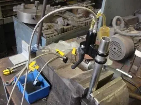

Pictures below show as returned from powder coaters, Reassembled and my home made bleeing kit and method.
They now work better than before and look the mutts nuts.
Enjoy

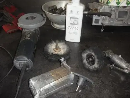

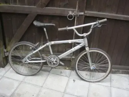

As for the frame, It being polished by hand one tube at a time and is also taking an age. it too looks the dogs danglies!!
