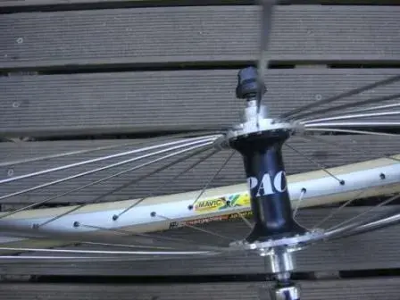

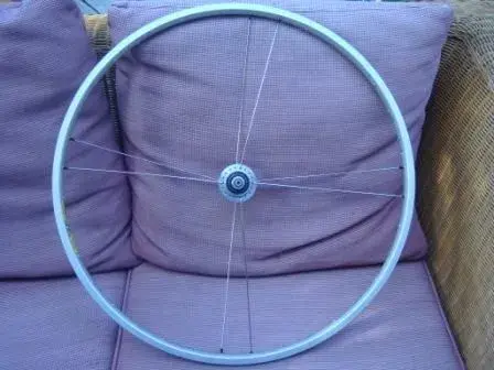

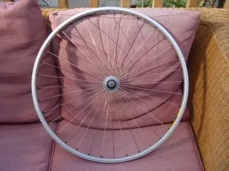

In case anyone was interested I built it Radial in the end.
I personally think it looks the mutts nuts, Though it did go against the vote.
Thank you for your comments and guidance. I'm sure I'll need it again on my next RC100 project.
Enjoy the pics.
D :wink:
