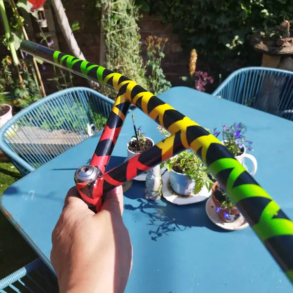

Really nice result. Talk us through the primer and paints. It's a minefield for the home sprayer. I've got a 2K MIPA primer aerosol lined-up for some forks.
Honestly.... I went halfrauds!
White primer, 2 days till...
Red, green and leftover yellows from the bees neez. (Halfrauds again)
Leave again for a few days then fine wet n dry all over for imperfections.
Leave a week (working )
Then using tamiya fine masking tapes (as in modeling) wrap, wind, design as required. Spray with black gloss, leave to dry, then a second coat for good cover.
Remove tape when touch dry or happy you got it all covered.
Clearcoat (2k online) leave to dry then using fine wet n dry sand all over lightly, this ensures an even feels over the masked areas.
Apply decals and then apply another clearcoat, sand lightly, and so on until you are happy with the finish.
Well, I'm no expert but this is how it's gone down so far.
