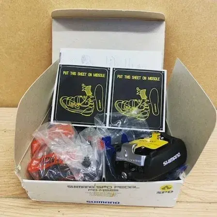

Next to arrive was a brand new set of DX M525 pedals. These were the first SPD pedals i ever owned and being known as DX they were a must for my build. My first pair of SPD's were matched with a pair of Nike Poobah boots, I wish I had kept those. :(

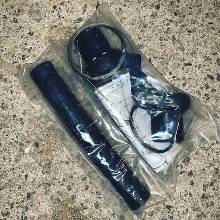

Then came the Gripshift SRT-600. I never had the 600 as I went straight the the cracking 800 ;) but the 600 body and all black colour are quite iconic, well for me at least.

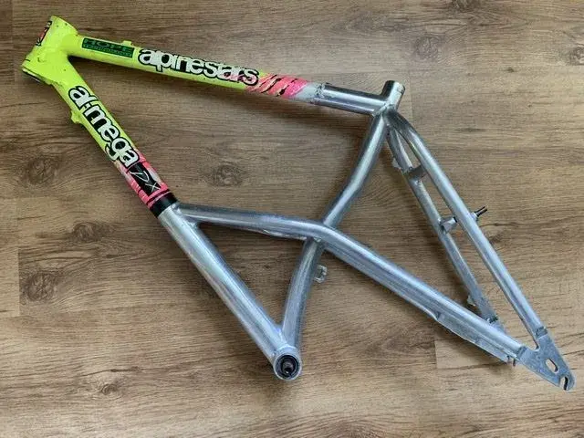

Re: Frameset back from Paint

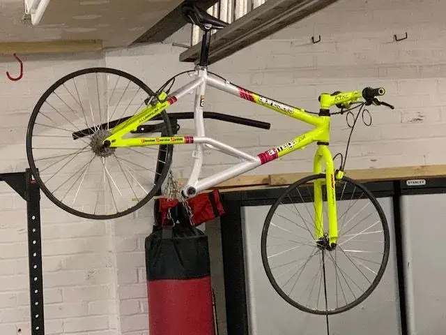

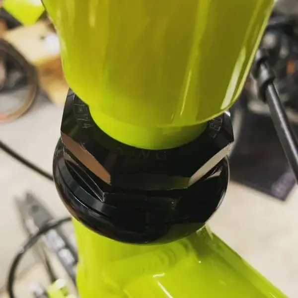

The bike spent a few months at Argos Racing Cycles in Bristol getting sorted. The job card included full respray and new decals from retrodecals (cheers Gil), removal of the old, bonded in BB, repaint A-ATAC stem and Bullseye cranks and fit the Chris King headset. We're all familiar with the logo'd CK headset but this blank, 1 1/4 headset is a real find and very subtle with 'KING' only visible on the top nut.
So with the frame back from paint I fitted the wheelset and the other parts I had collected just to get a feel for the total look.
You'll notice in the pic there are also a pair of Magura HS22 Racelines, NOS Taperlite bars, Control Tech seatpost and a white label flite saddle.
It's worth pointing out at this stage I had noticed a difference in size between the new mainframe decals and the originals. I had an NOS large frame and a well used small for reference. A quick chat with Argos and they agreed to rectify. Cheers guys.
Seeing this assembled made me very happy, it is shaping up to better than I had hoped it would be.

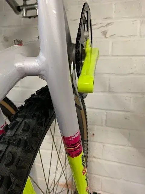

Re: Assembling and installing the crankset
So the crankset includes:
1, Bullseye bottom bracket
2, Bullseye cranks and spider
3, Bullseye inner chain ring bolts
4, Brand X middle and outer chain ring bolts
5, Crank Keeper
6, Mavic 607 inner and outer chainrings with a Stronglight middle
7, 3d printed axle spacers
So everything went together really smoothly. I like the the yellow and black colours broken up with the silver spider and bolts.

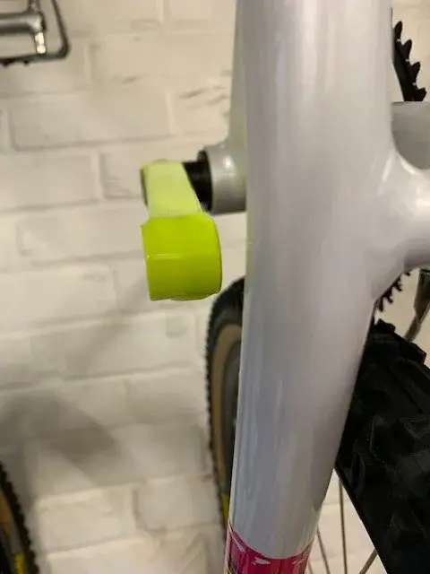

When installing the cranks it became very obvious that spacing and centralising the cranks was going to be a challenge, I wanted a perfect fit so measured up and 3D printed two spacers.
