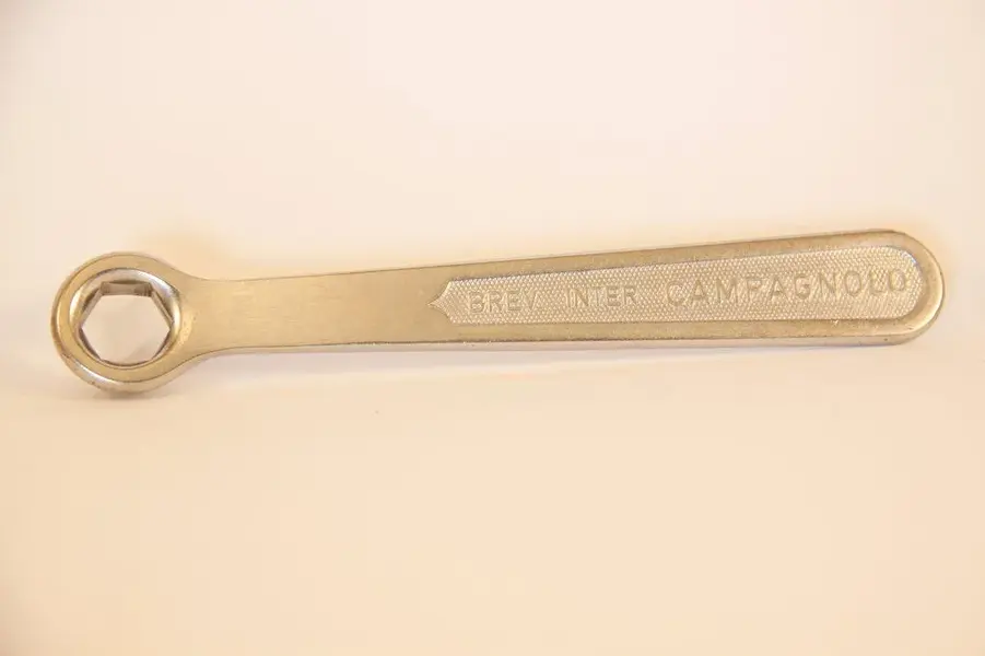

Can anybody tell me the correct tool to remove the campagnolo bolt that holds the crankset onto the bottom bracket spindle,
I've tried a normal 14mm socket but the outer is to big to fit in the hole
Neil
A standard crank remover tool usually has the skinny socket as part of the pusher bit...like this:
£4 or thereabouts from your friendly local bike shop
Or if you are feeling flush - you could buy a peanut butter wrench :roll:
