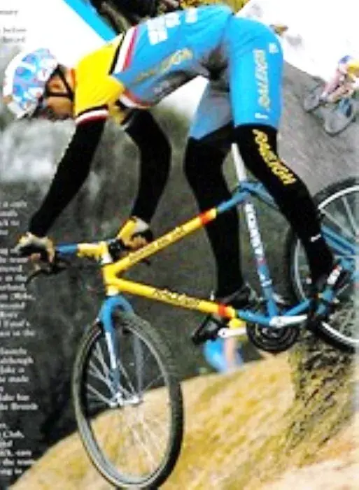

Were the team frames not made of Reynolds 753, with a slightly different rear triangle and a forward facing seatclamp...?

Good question, don't know if RSP ever built anything with 753. It had such special requirements and I can't see anything 753 in the catalogues, only 653 (Record Ace Moderne and White Lightnin'), the rear triangle does look a bit different to mine though.
They may have outsourced production of the team frames though like Peugeot did or just used the Avanti 531 frames? Bikemiester may well know. Whatever the outcome I don't care I'm happy i've got this one, but I love these investigations :mrgreen: .

Im not 100% to be honest ref RSP, but Raleigh always used Reynolds 753 for the road team bikes. Given the year the mountain bike team was formed i wonder if like many, Raleigh used the 753 tubeset, for the team riders, especially as these guys came predominantly from a road background. It certainly wouldnt surprise me..
There are so many variations with this livery, 531, 501, and a Hi Ten version too.
I think you are very lucky to have found a 531..... 8)
