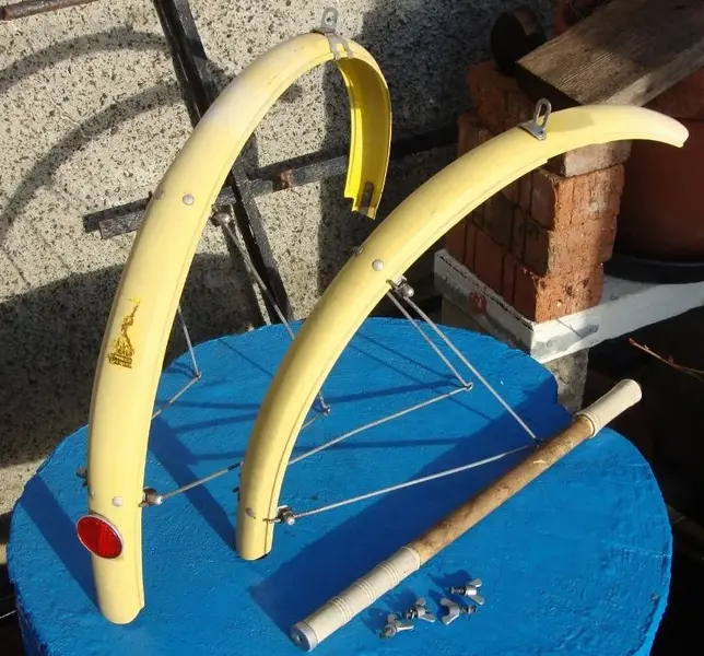

The bike came to me without its original mudguards. So I did some research on the web looking at old bike pics etc, think it would have been supplied new with Britannia celluloid mudguards, with front spearpoint, alloy V stays, and wing nuts. The closest I could get on the Bay was a set of Britannia mudguards off a green 1958 Raleigh Lenton Marque 111 – not many people breaking up Super Lentons these days!
Because the mudguard eyelets are located part way up the stays/forks on the Super Lenton, I had to trim down the original alloy V stays … with some regret :facepalm:
I was fortunate to get the original pump, the owner had wisely kept it in the garage separate from the bike. It’s stamped with the RI (Raleigh Industries) symbol however no other markings apart from 3 bands. Seems to be an alloy tube, with celluloid covering. Would this also have been supplied by Britannia?
It was functioning more as an extractor, however I sourced a new leather cup washer which was easily fitted (unscrew the old washer) … now it’s performing!
It’s an unusual length 18.5”, instead of the more usual industry standard 16”. I tried cleaning it with white spirit, to remove the brown staining – nae luck!
Adjourned … has started raining, again :shock:

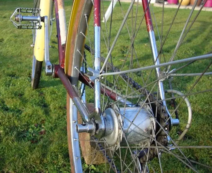

The weather relented here and allowed me to complete the refurbishment.
Why do mudguards always take so much longer to fit than anticipated, does anyone else find this? It took me ages to get them properly lined up etc. The wing nut fittings are great mind you (pic attached), so much quicker than fiddling with two 8mm spanners.
Anyway, apart from sourcing a few things such as tyres, Fibrax brake blocks, Adie ping bell, and possibly a less racy Brooks B66 saddle (nod to my age!), it’s ready for testing and use – hopefully I’ll achieve that over the next few weeks WP. I’ll report back on progress.
I was always aiming for “solid/presentable” and “useable” rather than anything more ambitious. Especially since the bike arrived in such unmolested condition.
All the work, at my own pace, has been a pleasure (not a chore). What I’ll do now is contact the original owner Michael, would be great to get a pic of the bike as it actually was in Swindon in the 50’s or 60’s, if such a thing actually exists!!

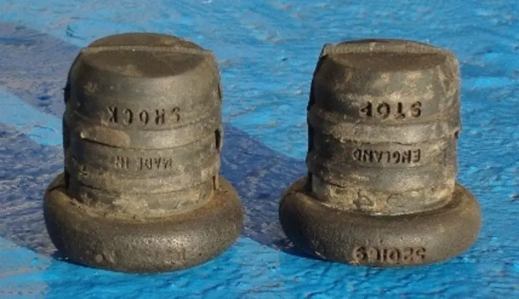

Thank you also Big Block for the steer and offer on Shockstop. Your message stirred a long memory, see pic what I found lurking in the garage drawer. There’s a scrap yard, Burns, just outside Edinburgh, where you used to be able to buy 2nd hand (house clearance) bikes for £5 a pot, think these came from there … about 25 years ago!! Those were the days. :?

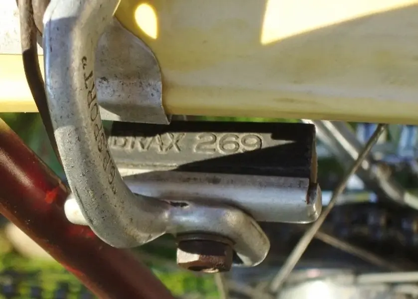

Thought I’d go for replacement Fibrax blocks since that’s what’s on the bike at the moment – see pic – although I don’t know what the 269 stands for.
Fibrax 269 pads were promoted as "Specially made for use with alloy rims. This new material has been specially produced to save alloy rims from excessive wear and is confidently offered after long periods of testing in the laboratory and on the road." see Brown Brothers 1952 catalogue p17
With those end plugs, it is time to start planning on the next project. I tend to concentrate on the late 1940s and early 1950s. I like the different approaches taken. One theme has been to show how each company approached gears: Osgear, Simplex TDF, Campagnolo Grand Sport, Cyclo Benelux and Sturmey Archer ASC. It does require a bit of thought for the first km of each ride.
Thanks again for the info Big Block. Looks like a bit of a mis-match on my bike then:- Fibrax 269 on steel rim !!
