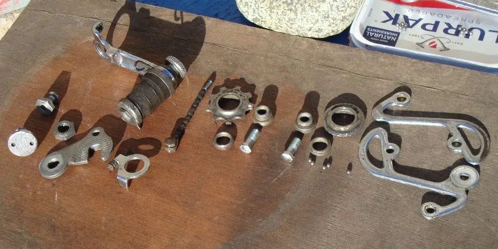

More history: I’ve never dismantled a derailleur in my life, so this is definitely a learning curve. The bike came with a Cyclo Benelux mk 7 plunger type derailleur, which I understand was sold between 1957 and the end of the 60’s - the previous owner Mike added this as an after-market fitment in 1959.
Anyway I found it to be a straight-forward and nicely engineered piece of kit, reminded me of the Sturmey Archer hubs: designed at the outset to be dismantled and serviced … no sealed units here!
I dismantled and cleaned up the whole thing, including internal sliding rod and spring.
I re-greased and tightened up the bearings on the jockey wheels, 15 tiny ball bearings per wheel – don’t attempt this on a windy day!
Then bolted the whole lot back together again, with oil.. No probs. See all pics.

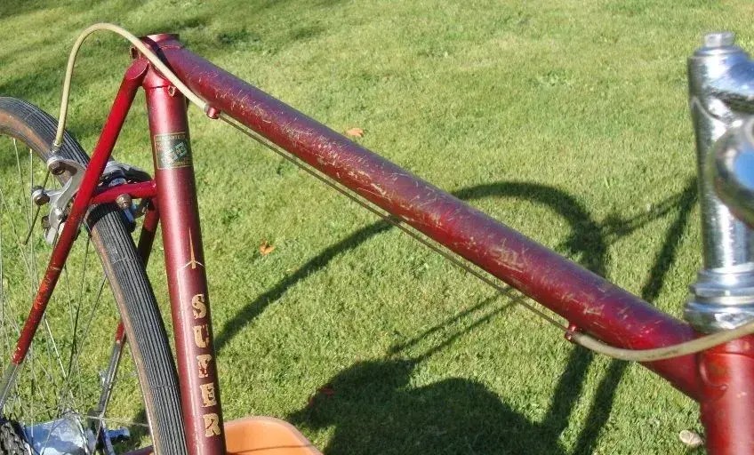

I’ve spent a bit of time cleaning up the original brakes and cables, and to be honest they’ve been a pleasure to work on. Apparently they’re GB Sport mark 1 hiduminium (high density aluminium).
Because the bike had been used semi-regularly over the decades, nothing was seized just a bit stiff. Nothing was frayed either. I discovered that the brake lever spindles can be unscrewed from their grey housings, for service/replacement purposes, which is great. They’re a wee bit worn, nothing drastic, anyone know where I can get replacement spindles??! :)
Anyway I made sure the original cables/wires were properly oiled through and through, and the brakeset is now back on the bike working like new again.
This may be the 1st time Raleigh applied bare-wire technology to the rear brakes, see the cable stops on the underside of the top tube. It definitely makes the rear brakes lighter and more responsive in comparison to the full-length flexi cable and wire.

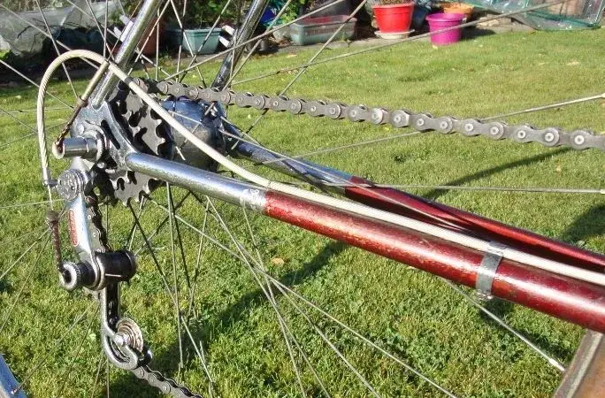

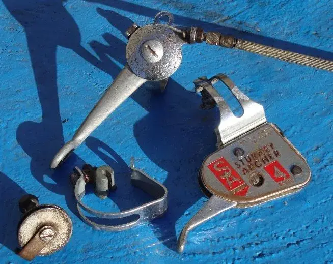

I’ve re-installed the mid-50’s sturmey archer 4 speed trigger and the late 50’s Cyclo lever, after a service/clean-up. The trigger cable linked up no problem. In contrast the derailleur cable wire was a bit frayed at the end, so I snipped off the last half-inch, before re-attaching.
At one point I considered converting to a “bare wire” derailleur connection (like the later Raleigh Lenton Grand Prix), however the Super Lenton frame pre-dates the useful brazed connectors on the Grand Prix’s chain stay. See pics.
I found setting up the Benelux derailleur was very straight-forward. Alignment with the large cog on the hub is by adjusting the knurled nut and lock washer – and tension adjustment is even easier, using the serrated cup washer. I notice that spring tension defaults the Benelux to the low gear position (large cog), suits me at my age! Whereas the default for sturmey archer is the high gear position.

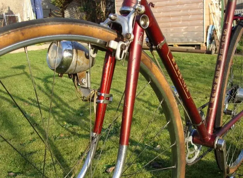

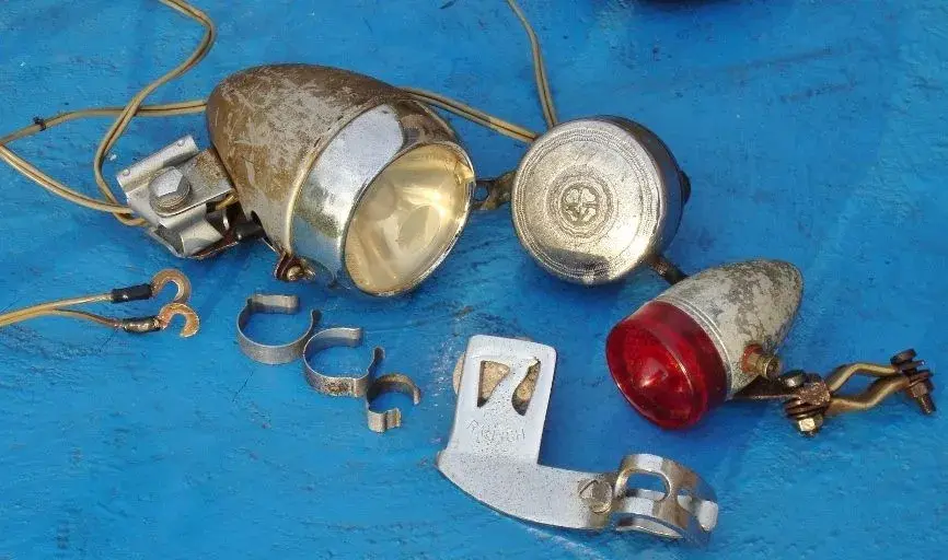

The bike was supplied new with the Sturmey Archer 6V Dynahub option, unusual for a Super Lenton. Speaking to the original owner Mike, he always intended the bike for touring rather than speed – so guess it makes perfect sense!
Other than cleaning it all up, and soldering 1 of the front wheel spade connectors, it all went swimmingly. I quizzed Mike about the rear light (which is Pifco – now there’s a name from the past! - rather than Sturmey Archer), and he confirmed that he’d never changed it, the bike came new like that. Guess Raleigh Industries used what was available at the time.
The front Raleigh lamp bracket fits over a brazed nipple on the front off-side fork leg (see pic), so no danger of the bracket shifting and stripping the front spokes … doesn’t bear thinking about! :shock:
The original bell as supplied with the bike is also back on. I’ll likely change this for a lighter Adie ping bell, hopefully source one off the Bay. Does anyone know when these became available? - were they for sale in the mid-late 50’s by any chance?
