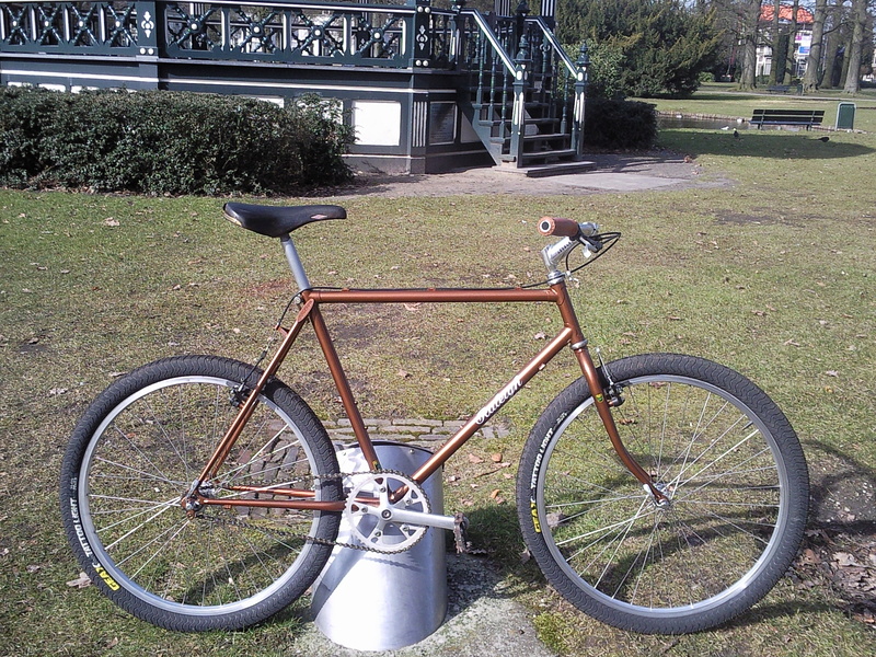

Some update on the Raleigh:I had a problem with finding a stem that fits.
In the pics is the original one, bit it is to long, I really don't like this lazy steering.
I have a few other 1" stems lying around, but the inner tube isn't the normal size 22,2mm, but 21,1mm.
I've been looking for such a stem, but couldn't find anything but race stems with negative raise and 50-60mm long.
So I had a 22,2 stem CNC'ed down to 21,1mm, and it works fine!
I also fitted another crank and ring with a better ratio (42-16).
Will make some pics next week.
So, finally a nice sunny day after months of snow and rain.
Nice day to take the Raleigh for a trip.
It rides very smooth and relaxed with the big tires and steel frame.
Perfect for cruising on the road and some flat forrest routes.
I still want to outline the lugs with some striping, but can't find this striping tape no more.
BITD you could buy this in any car shop, but I guess it isn't cool any more. :wink:
I had a little problem with the back brake, the frame has no cable stop :? so I put a ring bolt in, and it works fine.
