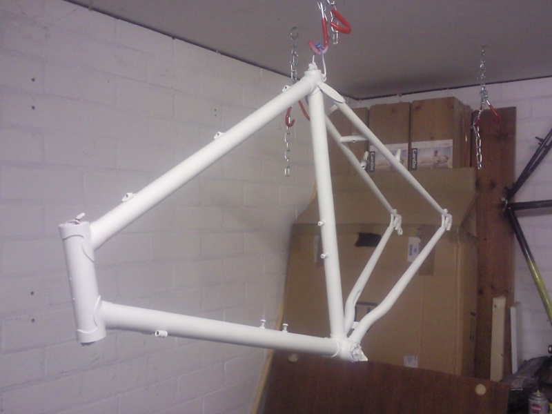

Allright, finally some action on this project :) it's going to be a single speed for road/forrest routes use.
Stripped the frame, put on some primer and tomorrow a nice brownish color.
Rest of the parts:
shiny handlebars with lots of backsweep
brown leather grips
Rolls saddle
Geax balloon tires
