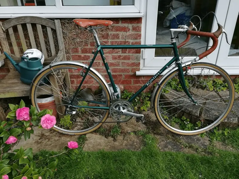

Here's my later 708 Royal with a shimano M550 Deore LX chainset
