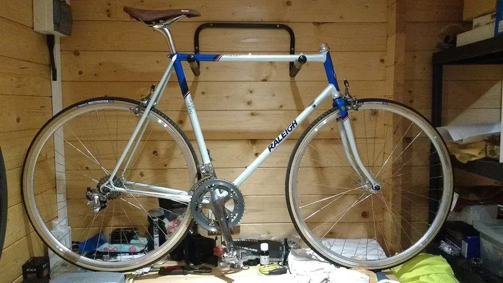

Apologies for the poor cell phone pic...WIP
Went for the retro-modern look, as a modern Ultegra 12-30 cassette on the 105 5600 group (52/39 chainrings) will be a bit easier on the hills for me than the 600EX 13-18 (not shown in the pic - current is a 12-25 from the 105 groupset, but have a 12-30 to fit).
