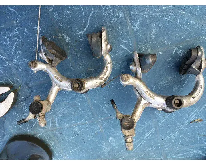

Crappy brakes :twisted: One is dated 1983, the other 1985.

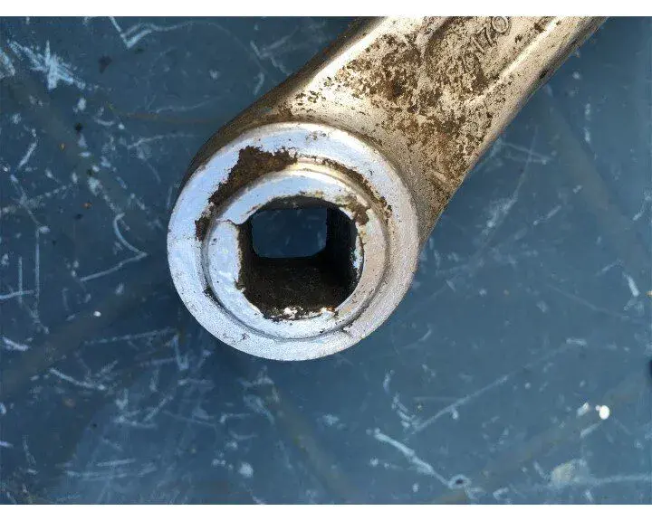

Cracked (ridden loose) left crank arm

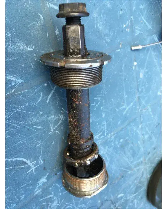

Bottom bracket lubricated with grit :roll: that was a pain to get out
I got the lock ring off easy with the C-spanner then the pin tool wouldn't budge. I used PlusGas, then used a rubber mallet to beat the pins firmly in, followed by a whack with the rubber mallet on the end of the lever. Done. Same with the drive side cup, but with a flat spanner.
BB threads look good.

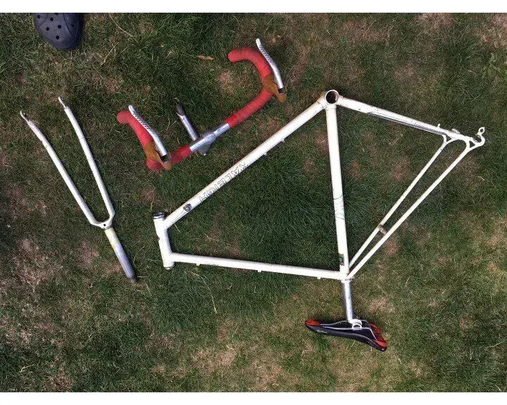

The saddle and seat post came from my spares box, the seat post is a road one and at max height is just right.

Brakes: Weinmann, worn-out flexy tat

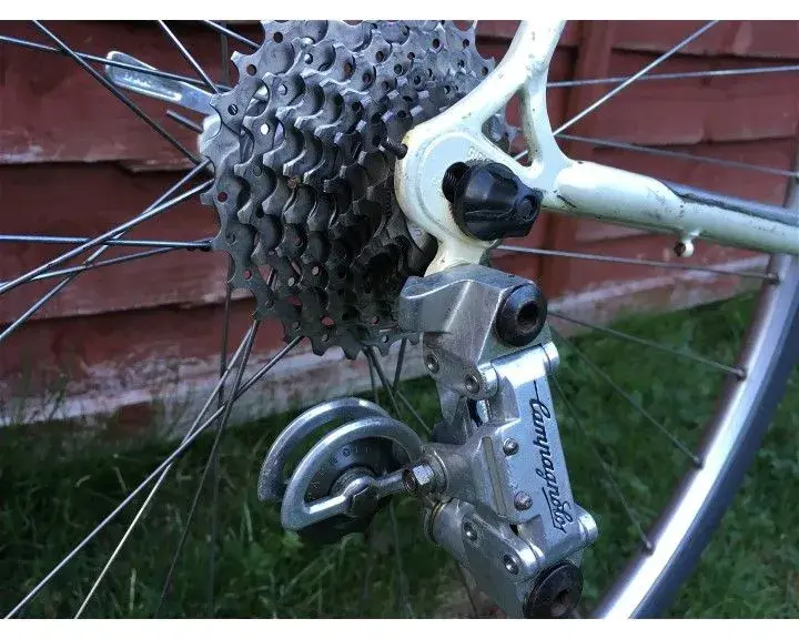

Gear levers: Campagnolo
Front Derailleur: Campagnolo
Rear Derailleur: Campagnolo
Cranks: SR 170mm - wrecked

Cassette: 6 speed, worn out, greasy
Chain: Unknown, worn out, greasy

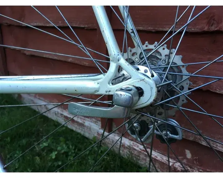

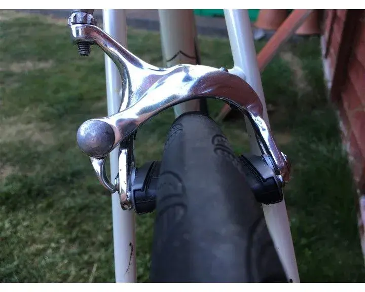

- Fitted wheels to check alignment, found the wheel slightly tipped to one side
- Applied PlusGas to adjusters, one came free - yeah!
- Snapped off head of second adjuster :facepalm: cut slot in it, tried screwdriver, cracked off :facepalm:
- Cut slot in other end..... snapped off too :facepalm:
- Filed bolt flush with drop-out, centre punched it, drilled out gingerly with 1.5 mm drill bit. Spent ages trying to keep it straight, came out <0.5 mm off centre as it exited
- Opened hole out with 2 mm drill. Opened hole out to 2.5 mm. Tapped new thread in with Lidl tap set
- Found skanky M3 x 0.5 mm pitch bolt in spares box, fitted :mrgreen:

- Unknown front brake

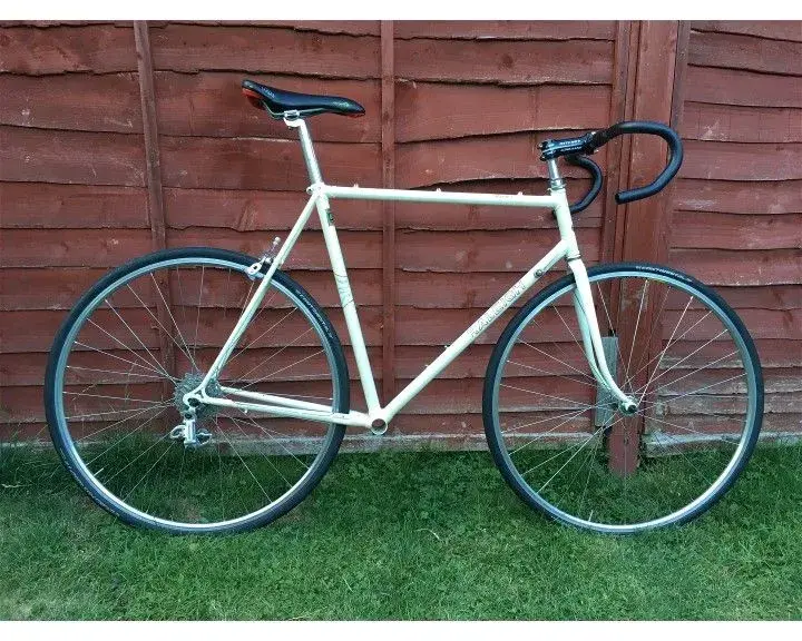

Shots show it mocked up for sizing. I looks flippin' awful with the quill adapter! My phone camera struggles with the pearlescent paint too.

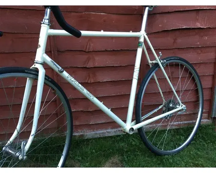

Proper mash-up this is...
The adjuster turned out better than I'd hoped. It'll be fine with the new bolts.
