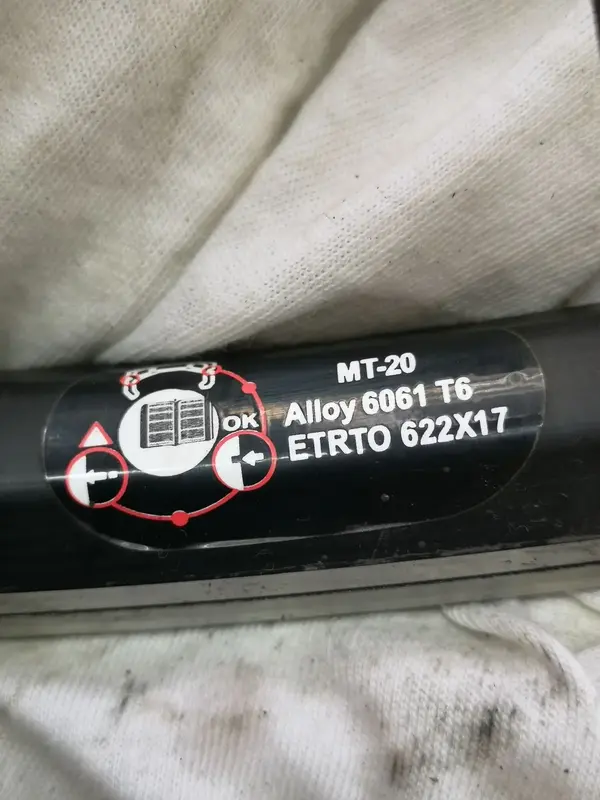

With the 700x42C (44-622) tires fitted I was looking for something a tad wider.
So, I've been looking around & I like the look of the Double fighter II tires & as the pic shows it's suggested they would fit onto the current rims? anyone disagrees or has any better suggestions? I (plenty of room between the dropouts.)
The wheel rims where the tire beads sit measures only 16.55mm which seems fairly narrow!
