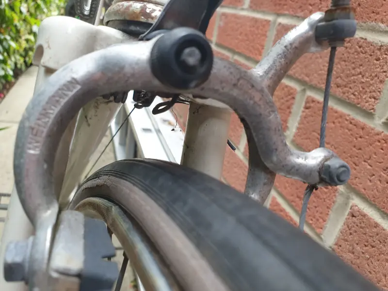

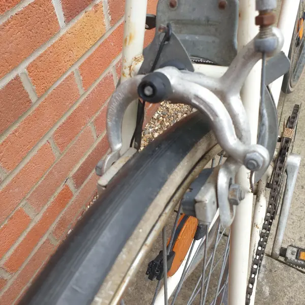

Weinmann type 730 side pull brakes
Weinmann levers

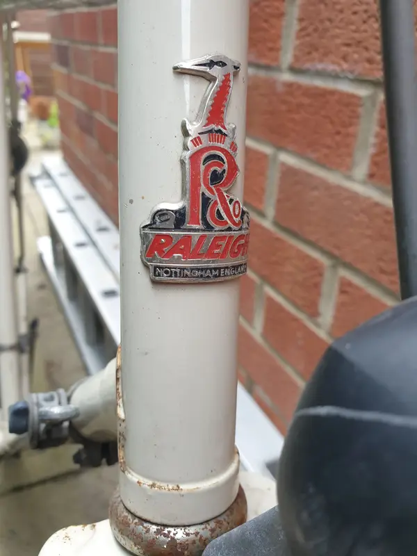

Stuck on raleigh Nottingham head badge not a transfer

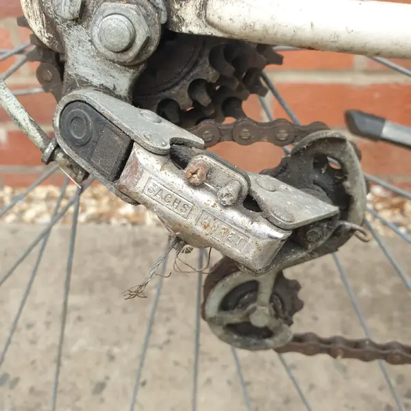

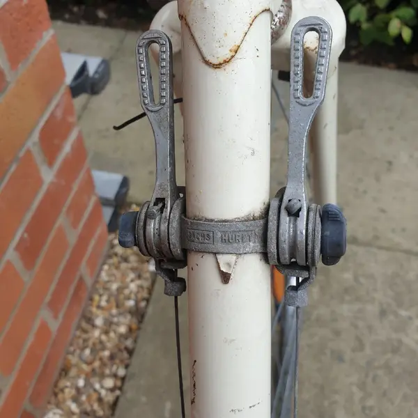

Sachs hurret clamp on friction shifters
Sachs hurret front and rear mech

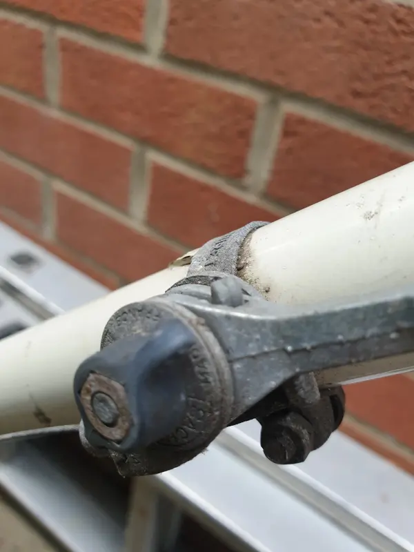

Crank arms stamped custom

Where you are located (i.e in the UK or Canada or the US) will probably have a bearing here on the exact model and the components used on this bike are very common indeed, there are a lot of Raleigh's from a lot of different markets that use pretty much that exact set of parts. The only help they give are the Sachs logo's which mean they are the later produced parts but that's still a pretty wide range.
There should be some date stamps on bits that will help though and the brake calipers will definitely have some on the reverse that will at least help with the dating if they are original.

I could be wrong but I thought the Sachs Huret logos were later than 1975, more like early to mid 80's. Take a look at the date stamps on the back of the brake calipers as they may give you a better idea of the age.
Looking again that head badge looks more like mid late 80's if not early 90's to me
