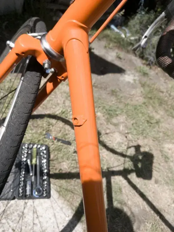

Could someone tell me what these rivets are for? They are on both sides. They can't be for the downtube shifters because they aren't threaded. But they seem to be pretty slap bang where the shifters should be. This bike has the clamped kind of shifters.
Thanks!

ZG862
My guess would be that they were a brazed on gear boss that has been taken off to allow fitment of the current "band on" levers. Are there any signs that there was once a post emanating from the hole visible in your picture?
jamman1125
That would make sense but I don't see why there would be the banded shifters in addition, as I believe the banded shifters on the bike are original. Can't really tell if anything used to be in there as this is a fresh paint job.
