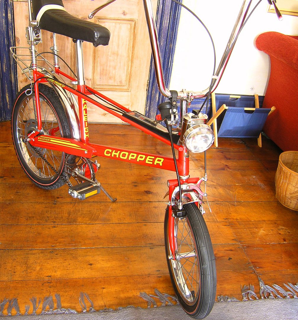

MK1 had straight rear stays down to the drop out whereas MK2 had curved stays - I think MK1 frames would snap here so the design changed

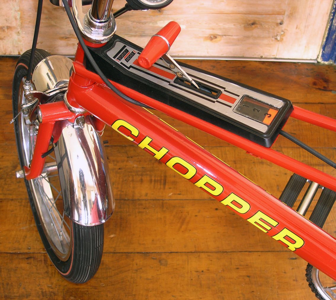

MK1 had black gear knob, MK2 had red lever
MK1, i believe, had wider bars and the bar angle could be changed at the stem, MK2 had a fixed stem and more narrow bars

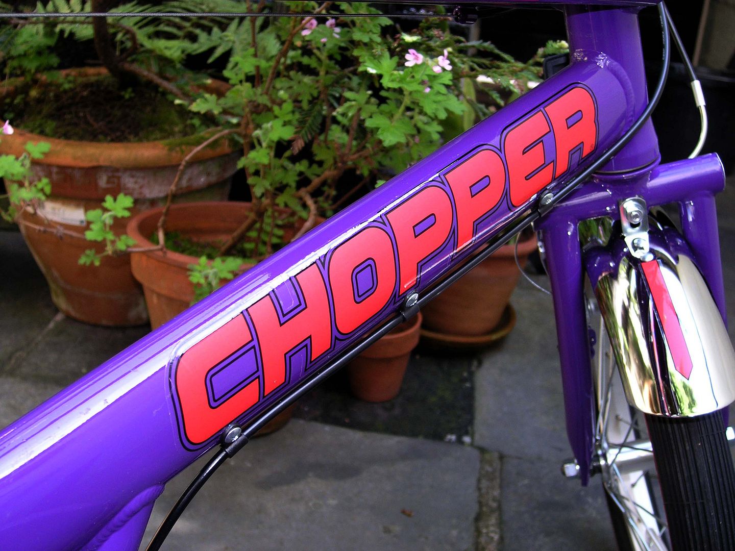

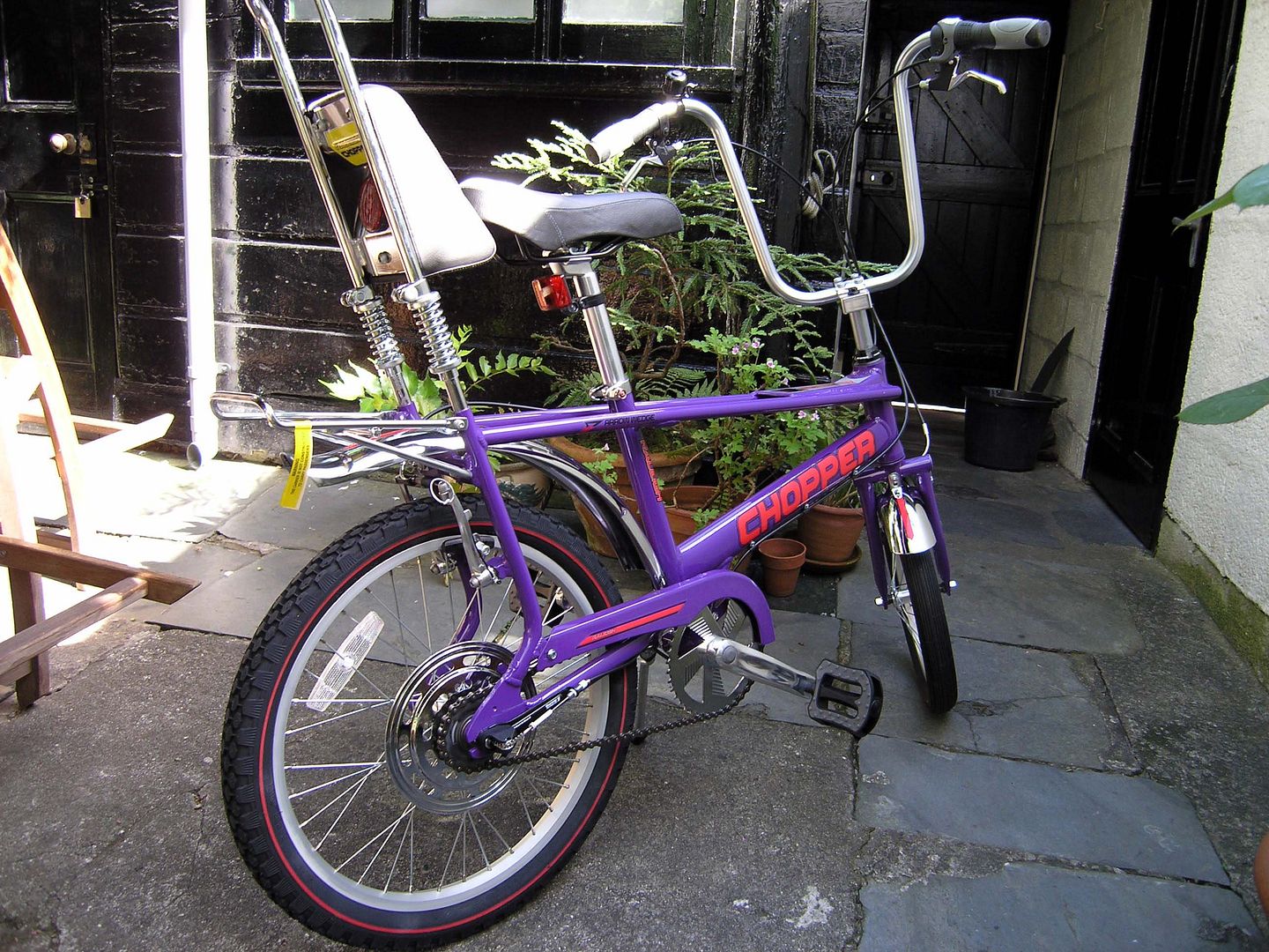

When i gt a moment I get some words together. I have a mint 1977 Mk2 as well as a mint Mk3 in purple.
The first edtion of the Mk3 was in red and purple.
