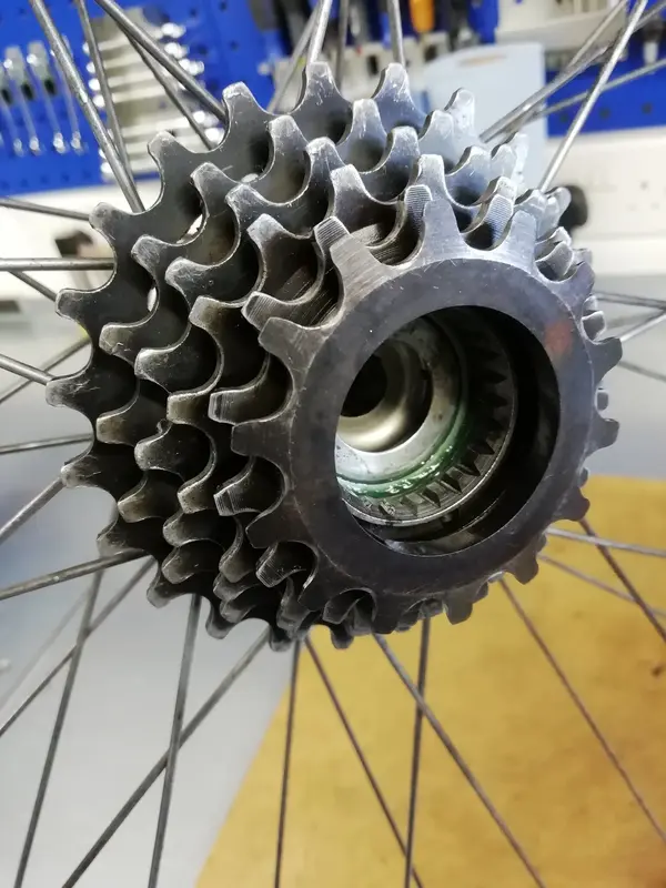

Anyway, can anyone tell if the cassette is a jobby where the small cassette sprocket is the lock ring & needs to be unscrewed using two chain whips? Alternatively there is a 24 spline cup down in the well of the cassette body. Think you can just about see it in the photo. Searching for 24 spline freewheel removal brings up hits on "Maillard / Sachs / Atom / Normandy" freewheels.

That's not a cassette, it's a freewheel.

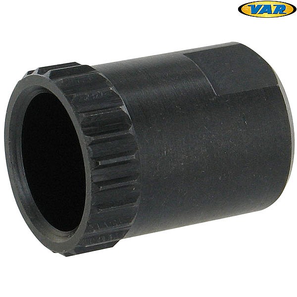

The remover you need is like this:
available from lots of places such as the one I stole the picture from
Lock the flats of the remover in a vise, seat the freewheel on the splines so the wheel is horizontal then grasping the rim like you're trying to steer a bus without power steering, attempt to rotate the wheel anti-clockwise. The freewheel will unscrew from the hub - sometimes easily, sometimes after considerable effort.
