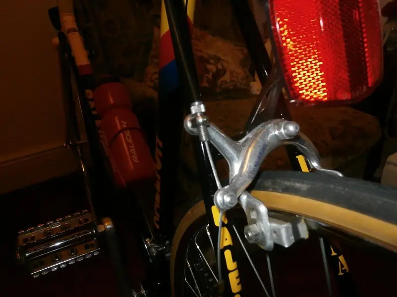

Hi my bike is going in shortly to have the Panaracer Pasela TG Road Touring/Commuting Tyre Puncture proof 700x25c fitted it has taken a while to get hold of these as the original seller on ebay promised a lot but delivered nothing so i have had to order them again ,any way whilst in my B/shop i was thinking of having some new brakes fitted as i want to start entering some stoke on trent cycle events and was hoping some kind sole could help me in choosing some better brakes as im not sure the ones fitted are up to much, any help please,best wishes Brian.

I have two late 80's reynolds 501 raleigh bikes, the kellogs pro tour and an eclipse. Both similar to the banana but further up the model range. I've owned the kelloggs from new (22-23yrs ago lol)
I've just fitted these calipers to my kellogs and they are brilliant, powerful, look very cool in black, and only £30 for a pair
http://www.wiggle.co.uk/campagnolo-velo ... -calipers/
They are dual pivot so far better than old raleigh brakes. I had to fit the long stud caliper on the rear. Along with new brake cables (only £2) the brakes are awesome, even with the original weinmann alloy levers (mine still work great so not worth replacing IMO)
I also got some new weinmann 700c black/silver wheels for £86 from my LBS (revel outdoors) which had the rear hub machined from 130 to 126 (to fit reynolds frame) and they have transformed the appearance and running of the bike. I was surprised to find a modern style wheel to fit the reynolds and old gearing setup. The rims on modern wheels make braking better anyway IMO
I've also ordered a set of these new retro style black wheels from USA for my raleigh eclipse, which i want to keep more standard/original looking

Check out the Big Autumn Clearout thread in Road For Sale. There are Some Shimano Rx100 double pivots calipers that are a bargain! These are cracking brakes.

Hi thanks a million for letting me know i will go take a look ,best wishes Brian.
