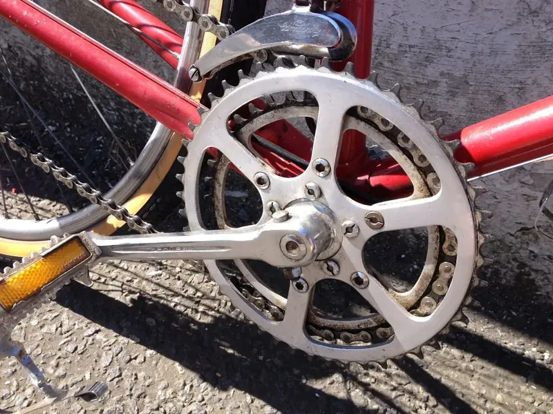

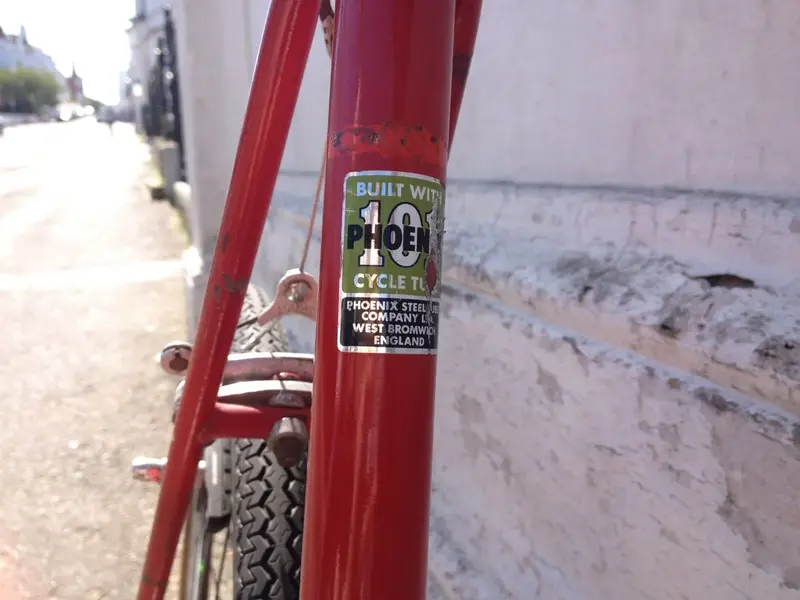

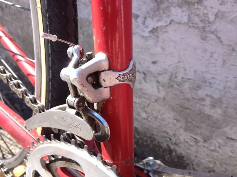

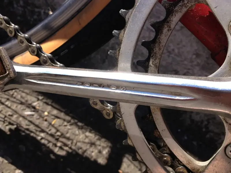

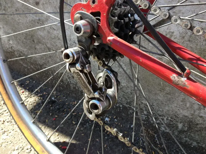

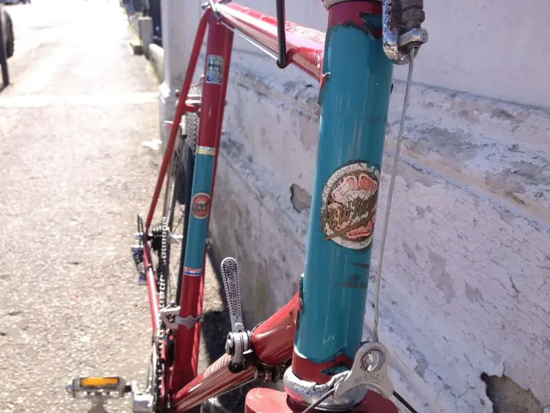

Here's my R.E.W. Reynolds that I got from our very own biggs682.
62cm frame. Phoenix 101 tubing. Nervex (?) lugs. Campagnolo Record front and rear mech. biggs682 estimated '60s or '70s, which makes sense to me, but I'm no expert, so I'd love to hear if anyone has any more precise a guess. Also unsure as to what component might be original?

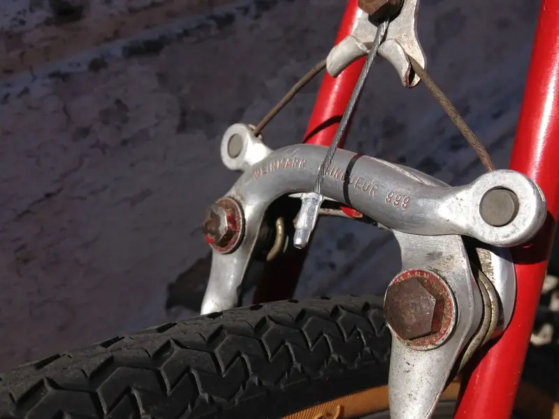

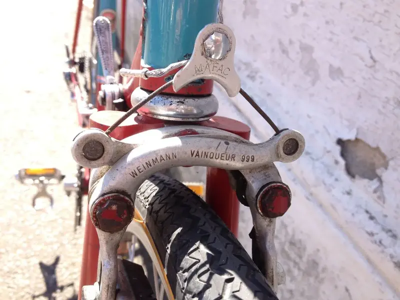

Got some Weinmann 500 side-pulls I want to switch the centre-pulls for

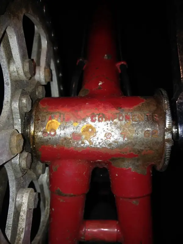

No idea if any stamped on details would help with dating...
(?) DAVID COMPONENTS...60...6827...62 (?)

Like the colour combo :). Frame looks like 70's with the Crespera looking lugs from the manufacture whose name has gone completely out of my head but made the concord lug series.
For a similar frame Google 1970 Mercian Campionissimo :)
Shaun
Lugs by Haden, just remembered. Your Weinmann 500's might not have the reach as they are quite a small caliper.
Bottom bracket is made by Davis.
Shaun

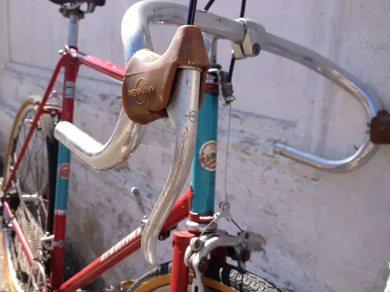

I've added some black cotton handlebar tape (tressostar). Will try fitting the 500s. The 999s are right on the limit as it is.

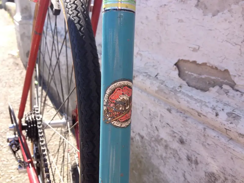

Do you have any experience with Phoenix tubing, I read somewhere is was an aviation materials company trying it's hand at tubing for bikes.
I wonder if that phoenix sticker was added after? Like Birmetals (another company) I recall they were later than perhaps the date the frame was made.
Good move on the Tressostar tape :)
Shaun
beardos i was told when i purchased the frameset all the components were original , so apart from wheels , stem , bars and saddle which were parts i replaced .
i have also since been told the R.E.W made quite a few frames in Phoenix tubing for what ever reason in the mid to late 70's .
