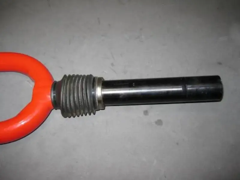

If time permits in the next day or so, I will get a photo of a steerer tube.

A Headshok as removed from a frame. Note the lower bearing remains installed, and if you look close you will notice the step for the upper bearing to ride on.
The step can be seen in the steerer tube photo. The step is about .010" larger diameter than the rest of the steerer tube.

The steerer has two machined lands to match the bearings.
