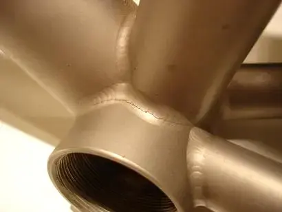

Hopefully it's going to be as original as I can get it without spending too much. I've got the wheels on the way - Pulstar hubs! NOS Stronglight Ti BB, NOS VP-104 pedals, NOS Tioga Stem & NOS seatpost, PFR bar ends, PFR saddle, just the brakes and drivetrain (all XTR) to get. The small problem I have is that the frame has a crack around the BB shell, I can get it welded by a frame builder but there is no guarantee, it could crack again in 6 weeks or last forever. So, I'm going to build it up first with the singlespeed kit from my Team 925, if it has any weak spots I will find them - I'm not the lightest of riders and use a lot of upper body strength when riding singlespeed.
