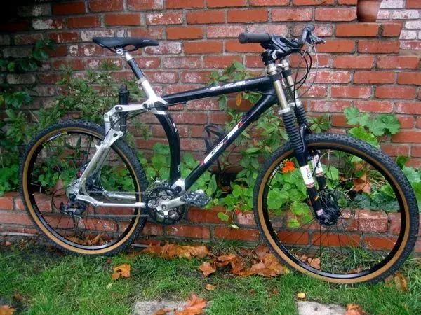

Rubber radiator hose of the appropriate diameter, black zip ties top and bottom. Looks good, even from a relatively close distance.
cornholio's RC200":306c0q9g said:
I do like that GT. A thing of beauty indeed 8)
Thanks. Looks even nicer now that it's got a properly sized shock. I do need to service the forks... They top out with a terrible clunk.
