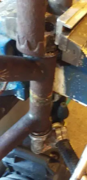

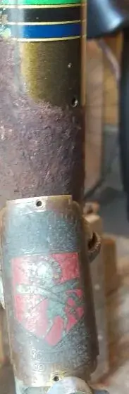

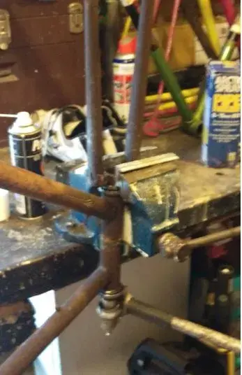

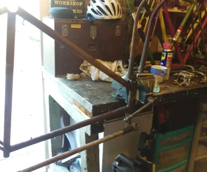

Well ordered the +Gas and a freeze kit then went out to take off the head badge and try a better set up. Badge off ok and looks like brass one although silver on the back. Found some decent paintwork at last. While it was set up I thought I'd have another go and with a loud crack I go some movement, assuming nothing broken!. I can more it up to about 45 deg with some effort. More soaking now I think and may be with +Gas once here.

That colour under the head badge looks nice.
Great result with the stem, just a case of working away at it and hopefully the +gas will make short work of it.

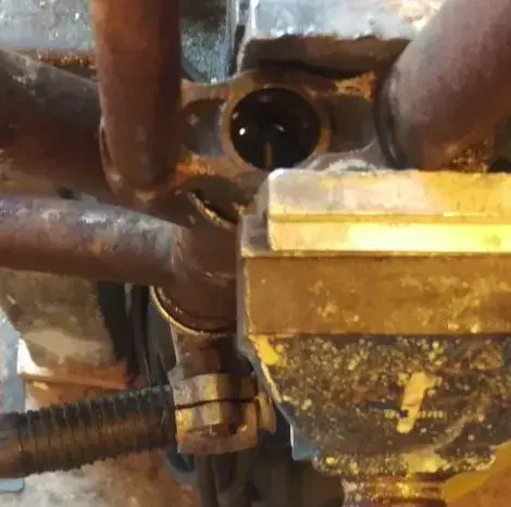

Still hanging on! got about half a turn on it, but no sign of coming out. Time to open the freeze kit i think

Evening David,
You’ve probably already got this worked out, but just in case this a new thing for you, gentle build up heat to the fork steerer so that the heat has traveled down the fork tube. When it’s as hot as you can get it, squirt that freezer kit down into the aluminium stem, then twist/hit it as hard as you dare... sorry if that’s teaching you to suck eggs... :wink: :lol:
