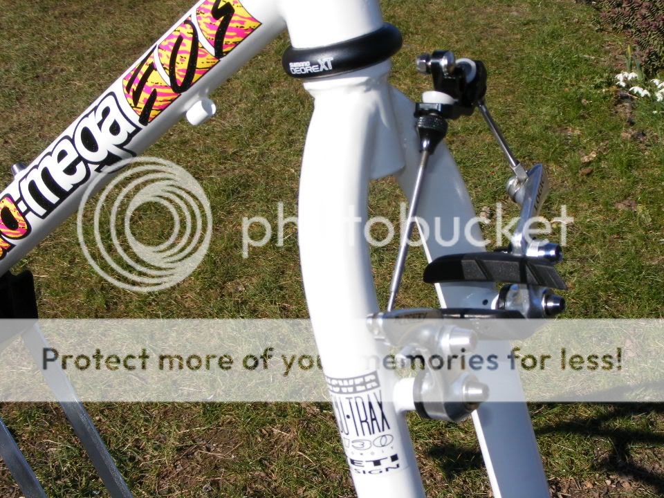

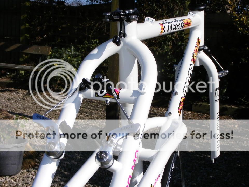

Therefore, I’m going for a conventional cantilever set up on my ultimate alpinestars cro-mega. The best cantilevers I’ve tried are the M900 XTR ones, but sadly M900 XTR doesn’t fit right on this bike as it was never really my dream to own it in 1992. So the only other viable Shimano brake system that fits with the build is the 1992 M734 XT cantilevers, but these are poor performers and rather plain in appearance. So I’ve taken a different route entirely by choosing a brake set that was a good aftermarket choice, the Ritchey Logic cantilever brake set.

Once more the Dia-Compe influence is apparent with these Ritchey Logic cantilevers sharing similar looks and common parts as the Dia-Compe 986 and 987 models. I like the look of these cantilevers, just simple and elegant, with performance to match some of the more expensive cantilevers on the market. Mine came in silver but had the logo’s missing, so I’ve matched them to build by painting the bodies in gloss black. The brake block holders have also been freshened up with a new coat of paint.

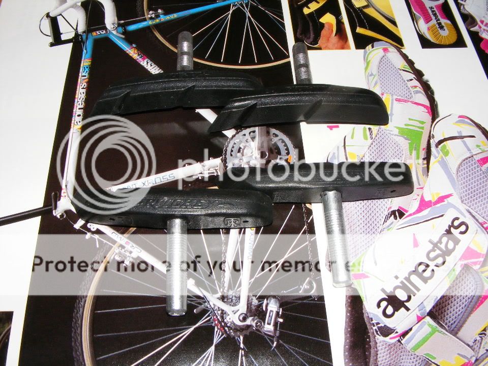

Cantilever Brake Pads:
To go with the Ritchey Logic cantis I went with Logic pads too. These cost just £2 a pair at CRC at the moment so are a real bargain. They should do the business in performance too.

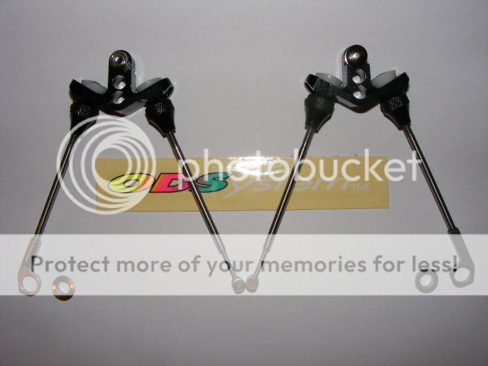

I decided I’d try something a bit new to me here, Odessey Straddle Rods. I’ve seen plenty of them on retro bike and they look functional. So when a set turned up on the forum NOS, I took a chance and bought them. They are black anodised so fit the colour scheme well and with luck will enhance the braking power of the Ritchey Logic set up.

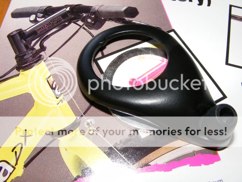

Cantilever hanger rear:
The alpinestars bikes from the early nineties uses a rear canti hanger that utilises the seat clamp. Thus these are fairly rare and therefore makes me quite mad that I’ve recently mislaid one. They were originally silver, but for this build I sent this one to the powder coaters for a coat of gloss black.

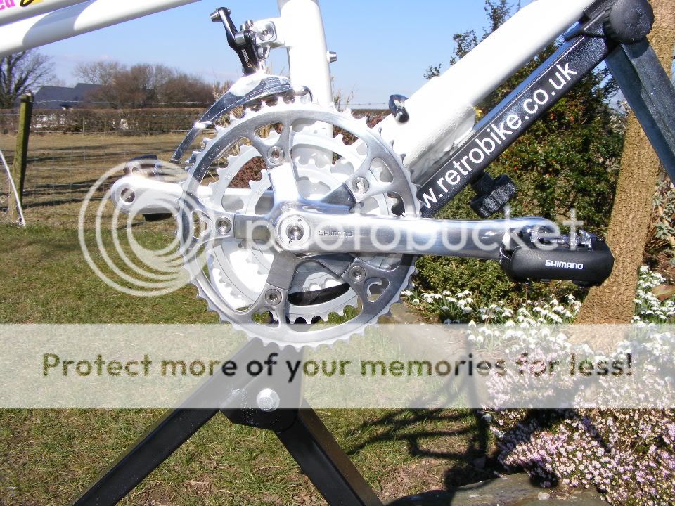

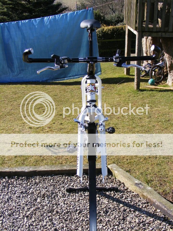

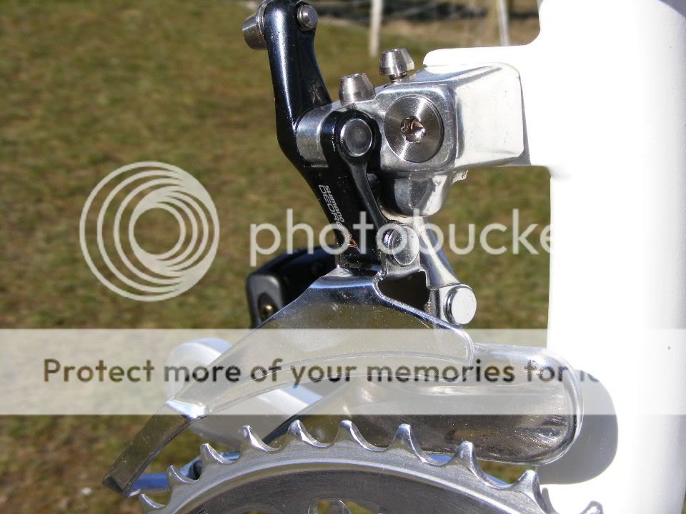

UPDATE

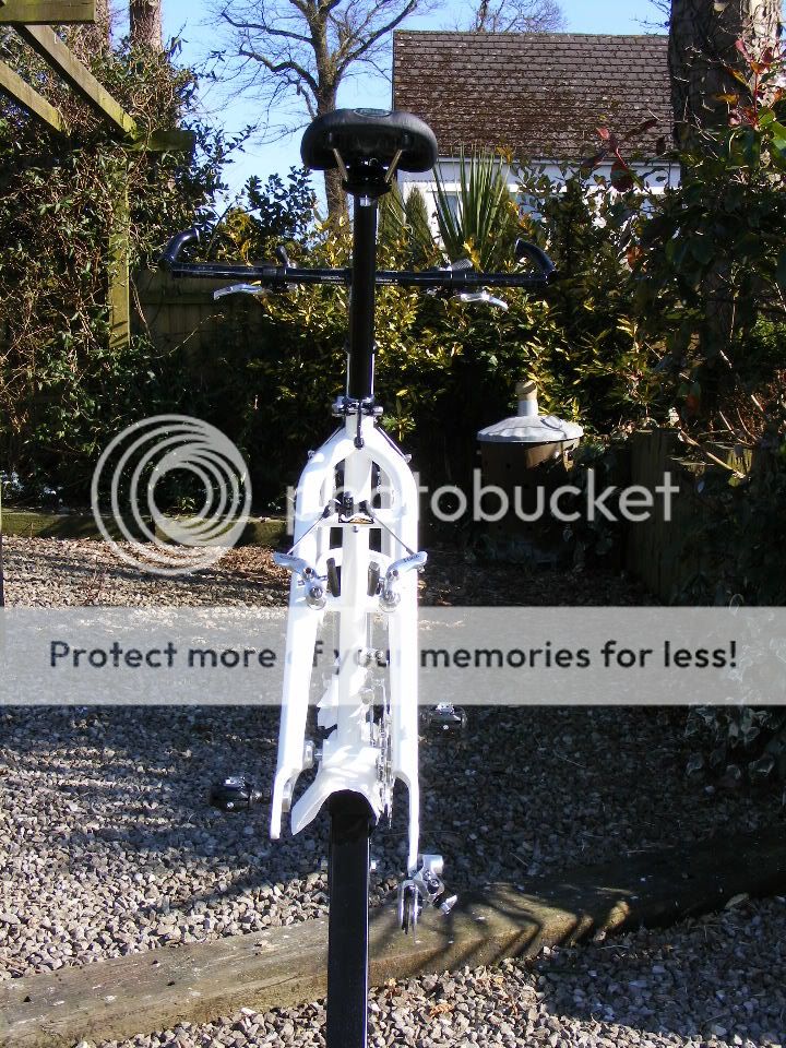

Reckon this project has reached an end for this frame and forks. I have a ti-mega frame with titanium forks on its way this week, so will be subbing those. Which is quite lucky for me as it turns out (despite my best guesstimation) the steerer on the Accu-trax, is about 10-15mm too short :oops: Anyhow here are some pics of how it was coming along.
I used to really like how this bike used to look. :wink: :cry:
Now I absolutely LOVE how it looks :lol: . This is a fantastic bit of inspiration for my own 'project all-white'
Steve
Looks Perfect Mark ! Your enthusiasm ,detail and passion is definately rubbing off on me. Love it ! :D
