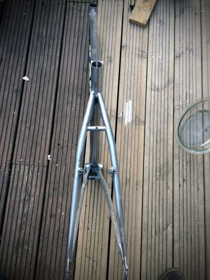

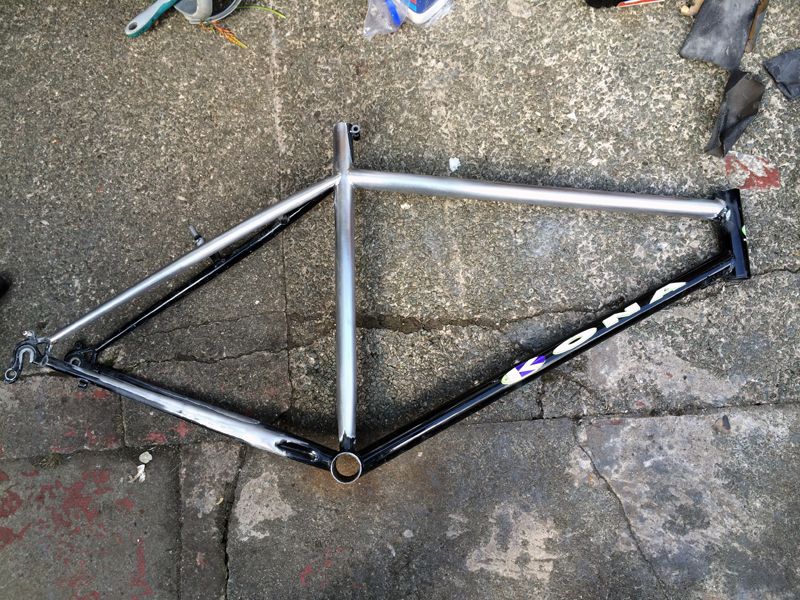

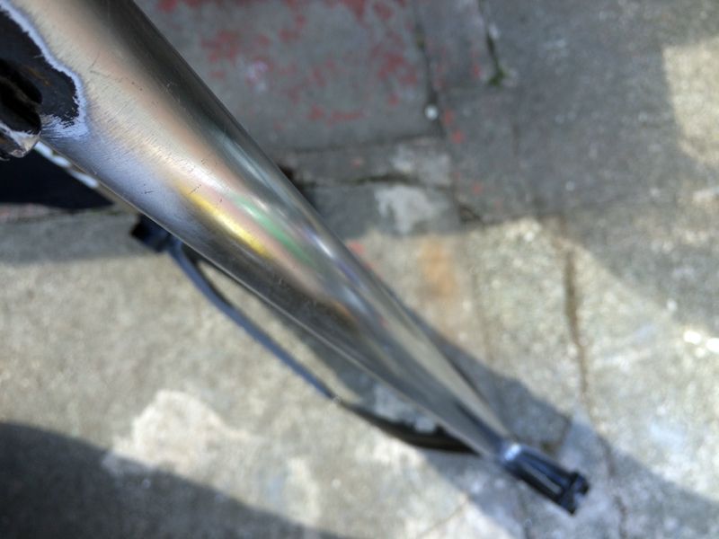

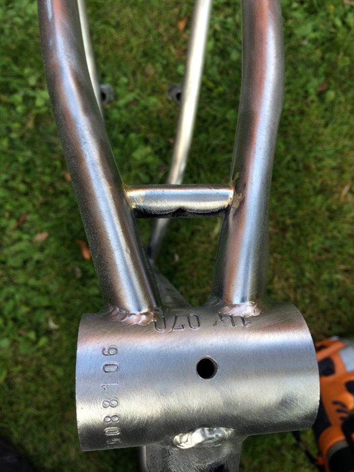

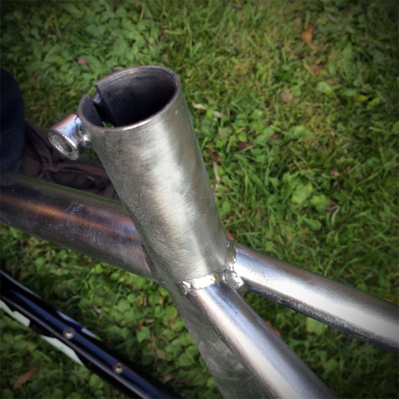

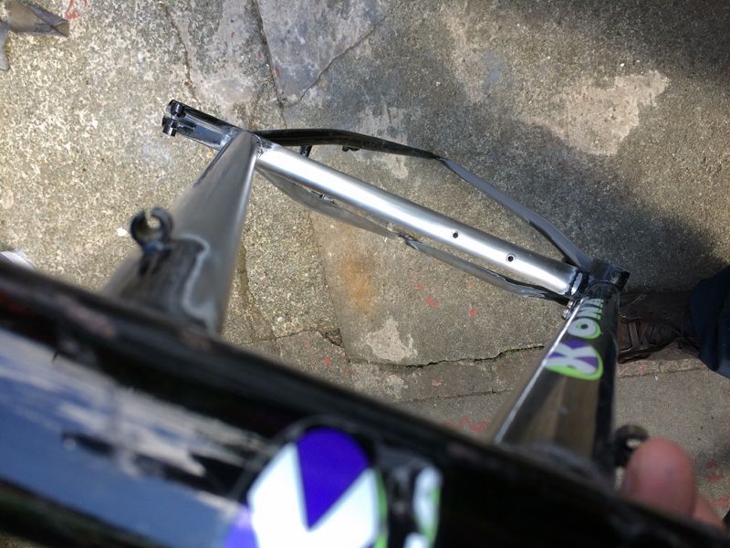

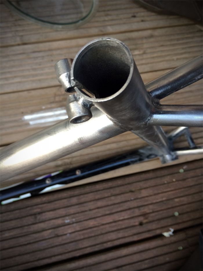

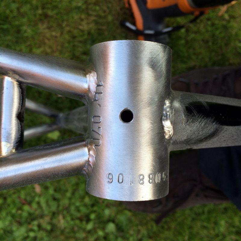

I'd carried out a bit of research and apparently good old Nitromors in its "new and improved formula" is is pretty rubbish. Its improved in respect that its nice and friendly to the environment but not very good at shifting paint from metal :( in light of this i decided to strip the Konas paint by hand. I found the paint to be quite soft and apart from the nooks and crannies pretty easy to remove with p80 wet, wet and dry paper .
nooks and crannies are being attacked with a brass wire brush wheel, drill attachment. Super tight spots will be handled with the dremel.
some areas of the frame look pretty scratched up but this is only the first level of sanding, i'll gradually refine the surface with progressively finer grades of paper. once im happy with the surface ill coat with acid etch primer and any areas of pitting (there are a couple) will be built up with high build primer...
