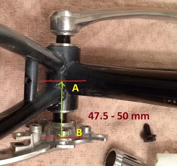

Diagram !
Assuming A is the bikes centre line
Assuming B is the mounting face of the middle chain ring
The ideal distance is between 47.5 and 50 mm ?

yep, B is the centre of the chainring teeth, and where you have it is where I would guess the middle will be abouts without the teeth.
113mm though, been mentioned a few times and since they came on kona's later on it has been documented in posts.

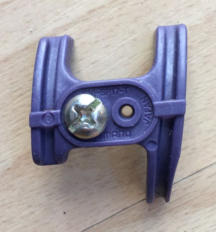

BB cable guide ..

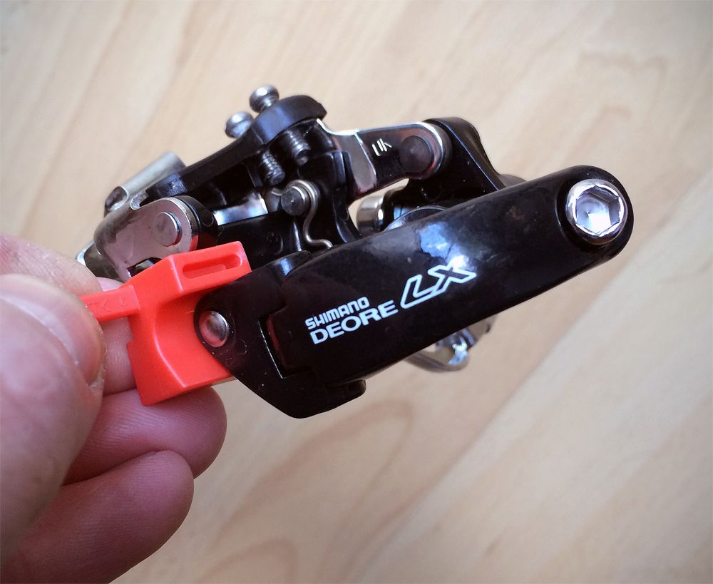

NOS, bottom pull front mech....

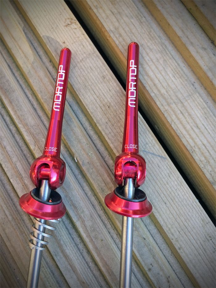

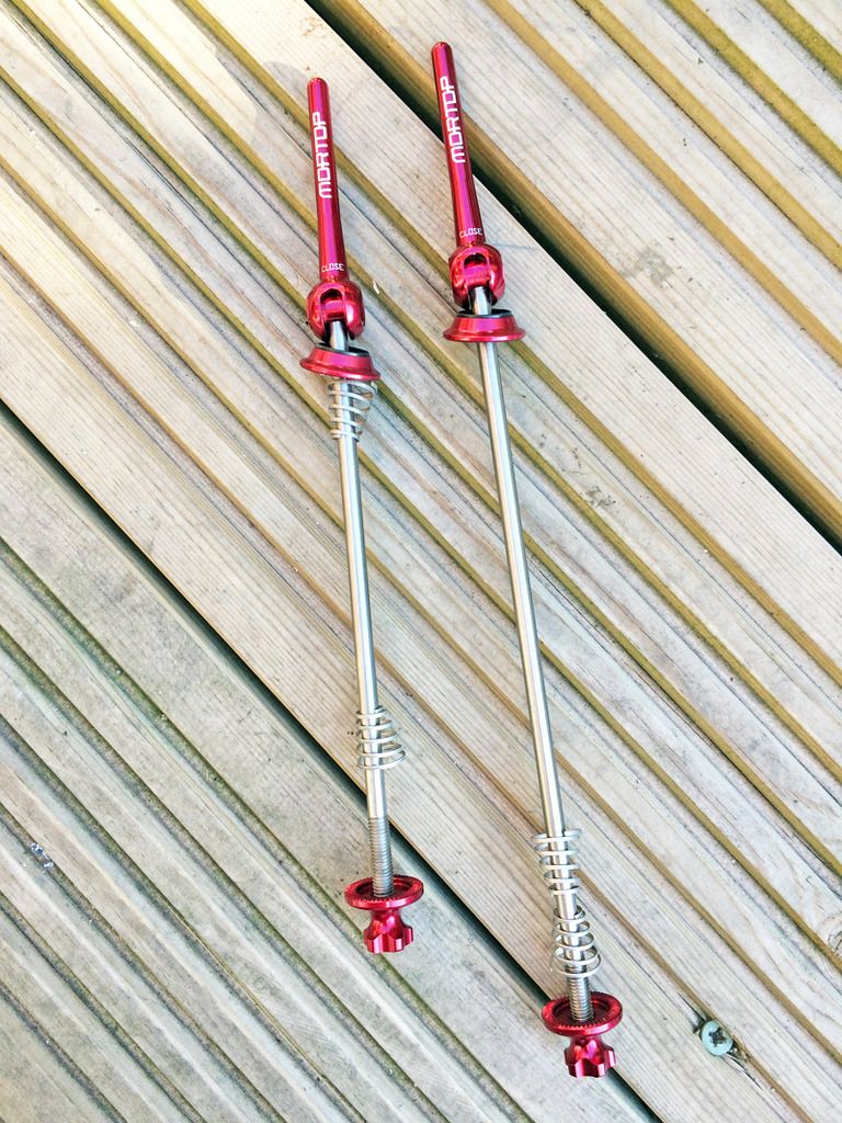

Titanium axle skewers, these are virtually weightless...

Those skewers look the Dogz and i quite like the green on the stem but if it doesn't suit the overall picture your after then fair enough mate ;) .
