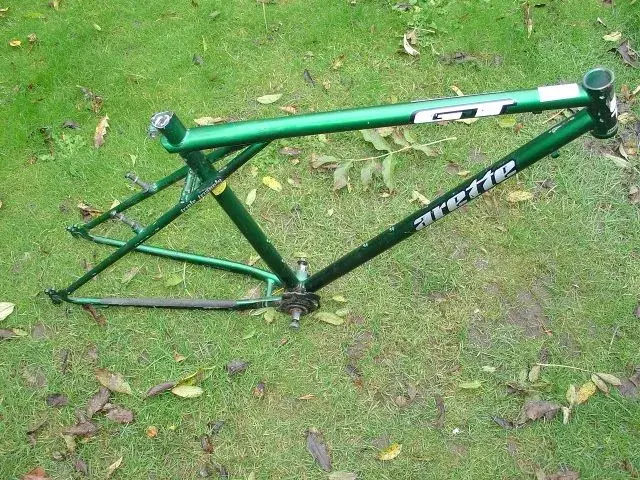

Hi All Just thought I would post update on My Project GT Arette Hybrid, Well I purchased this last month complete bike but found that the Seat post was welded solid in the frame, Stripped it all down and decided to sell frame on Fleebay, but then thought bugger it why not do it myself, so 2 Tubs of Concentrated Caustic (B&Q). and a very strong mix with warm water,dissolved the post out in 3 hrs, What fun we had me and the wife starring at a bubbling steaming black volcano pouring out of the Gt frame.( Little things Please us old guy's).
Anyway after that, thought why not strip frame back to bare metal, that was harder then seatpost, Blimey GT paint finish is bloody tuff stuff, but got there in the end.
