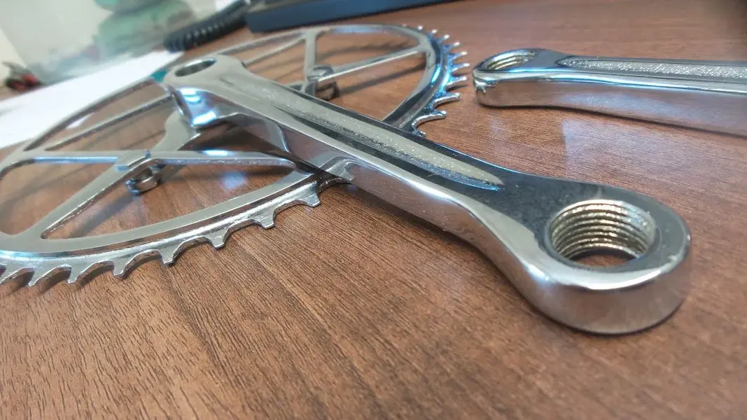

The williams fluted cranks have become a story on their own. I tried to clean them up, but when I tried to undo the chainring sleeve bolts two of them just sheared off.. I swore a little bit. I thought all was lost with the chainset. BUT thanks to the joy of retrobike, I discovered a little company called abel baker in bishop stortford
http://www.retrobike.co.uk/forum/viewto ... p;t=259213
after a phone chat to the guy down there who was REALLY knows his onions about vintage british bikes and components, I had 3 brand new perfect replica bolts on the way in the post. The bolts came with an hand written invoice for just a few quid, asking for payment by PO or Cheque - old fashioned wonderfulness, so the crankset was saved by Abel Baker..!
Now, from one old fashioned company to another - Over to Prestige Plating in Mexbourough - Actually the chroming is still pretty expensive, but their prices are the best I've seen this far. Both cranks, a chainring, 3 new sleeve bolts from abel Baker and the worst of the headset parts - they priced up at around 60 quid with VAT. Sure I could buy another secondhand set for less on ebay, but they'd probably be old, manky and rusty and I really like this set.... Hoping they will come out blinging like a 1950s gangster rapper.

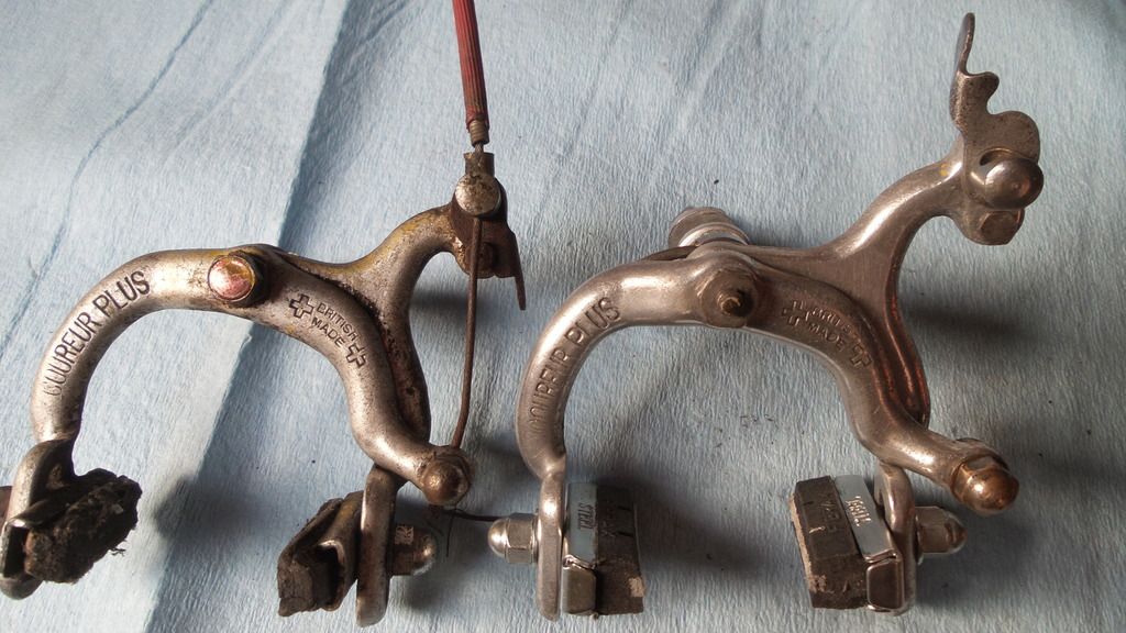

Meanwhile I'm slowly working my way through cleaning up a brake or two..
And yeaahhh... Fibrax Leather faced brake pads going on. Lets do it right (hopefully I'll be able to stop if I plan a few days ahead)

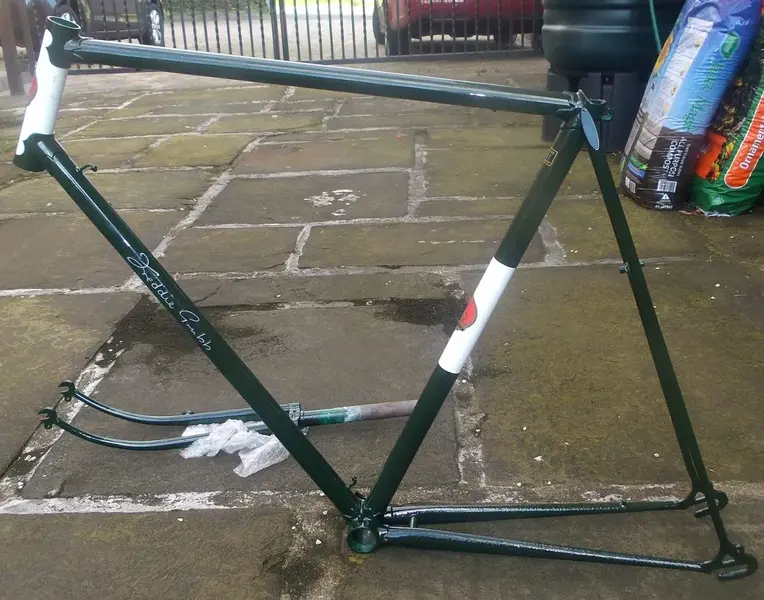

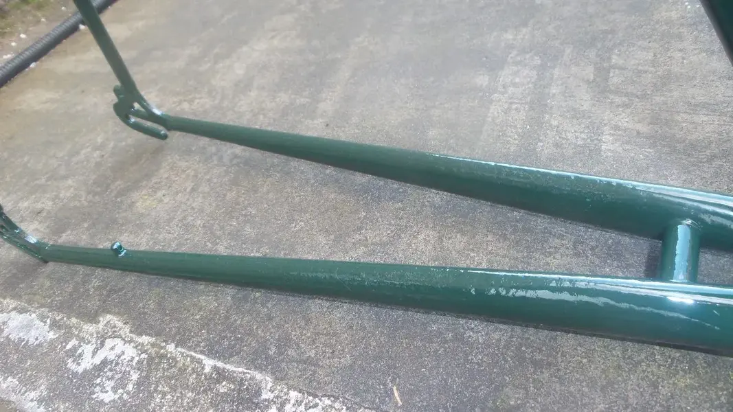

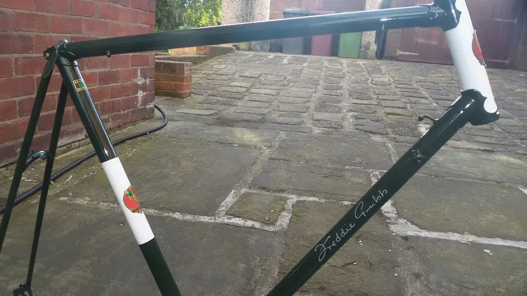

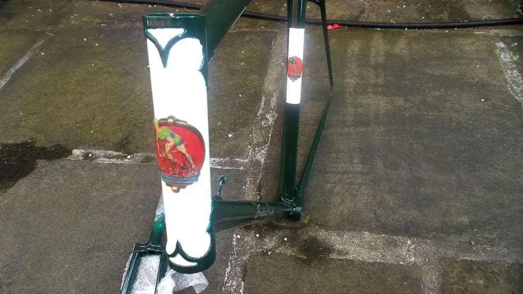

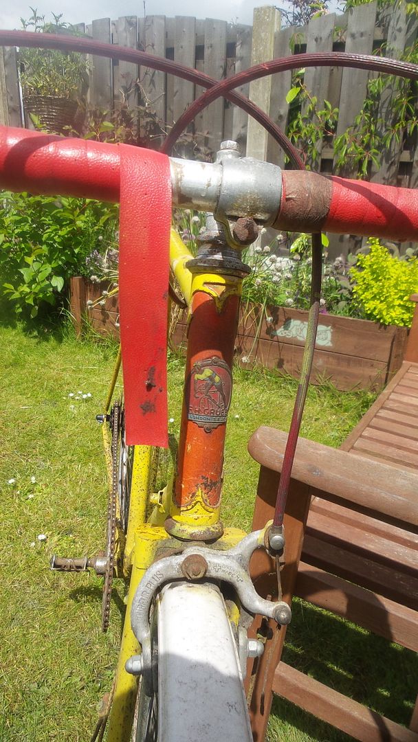

Got the frame back from Vernon Baker at the weekend, after 9 coats of stove enamel. The pitting looks far worse in the photos, it's actually really superficial and you need to be close to see it.
Looks pretty damn nice inspite of the uneven parts on the chainstays, I'm very happy with the BRG/White colour choice - and I'm not surprised it didn't come out perfectly perfect. Its nice in a way that it's still able to tell it's tale 50 years of neglect and being left out in the rain...
Just a sneaky preview with the wheels...

Before and after " what a difference " :o .
Before
What an amazing result after the painters have done their magic :shock: 8) which just goes to show that even when you think a frame is well passed saving theirs still plenty more life left in it just waiting to be found ;) ..
Yes you certainly pulled the rabbit out of the hat with this one mate and you must be really pleased with yourself and quite rightly so ;) ..
Yeap thanks - it seems to be working out good so far. Frame and wheels are currently living in my hallway, and it's starting to look pretty damn nice so seems a shame for it to be living in the garage :P

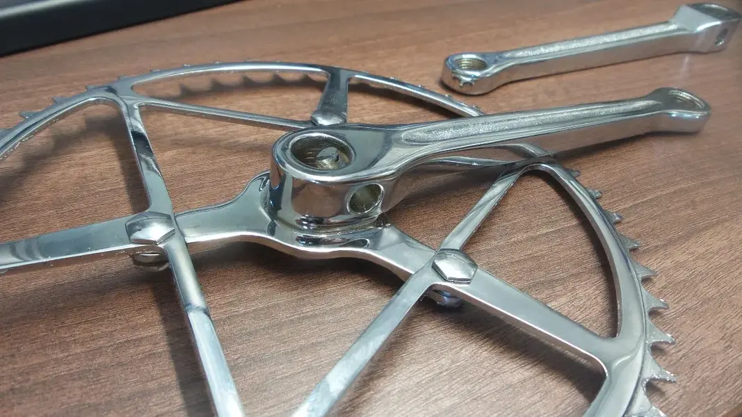

I drove over to the replating company this morning to pick up the williams C45 cranks. Glad I took the decision to refurb them.

No it's not looking nice it's looking amazing ;) and i'm glad you decided to go ahead with refurbing the C45 cranks as they just look glorious in their new found splendour and will just look perfect when refitted to the lovely repainted frame ..
