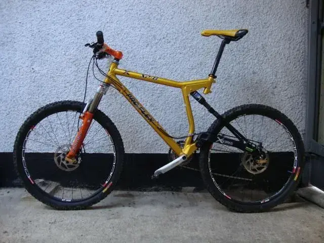

.... and very recent photo of mine, so recent in fact, the pixels still have not dried.
an orange saddle would look better - did Selle make Flites in orange?

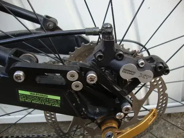

O2gf74: the Fox shock looks well on the rear of your bike, still not got around to fitting my adapter yet (working abroad still), you have a disc adapter for the rear as well? any details on that? or a close-up pic?
looks well but works even better - the modern air shock totally transforms ther ride.
there are several different rear disc adapters most of which use the axle as the mounting point. mine is a bit more complicated as it connects at the stay using a bearing to reduce friction (others have used delrin/teflon washer here) and the m5 hole in the drop out. unlike the rear shock adapter, i made this myself from 3 piece of aluminium alloy, bolted together.
a close up below, slots added for lightness
