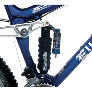

The noleen with the piggyback reservoir. That is noleen's best shock, an NR4. Worth rebuilding if need be. Best to put a sock on it too.
Cool, whats a good one to get then?

I use lizard skins shock boots myself. Keeps the sand from being driven into the seals from the bottom out bumper.
Yup, I use those Lizard Skins shock boot things front & rear, do a good job of keeping the crud out.
Shock choice on the Proflex is limited at the rear due to the stupid cone-shaped fitting they used, hence most shocks will noy fit unless you fabricate some sort of adapter up.
Noleen/J6 still sell the shocks though, and Risse Racing do compatible shocks.
