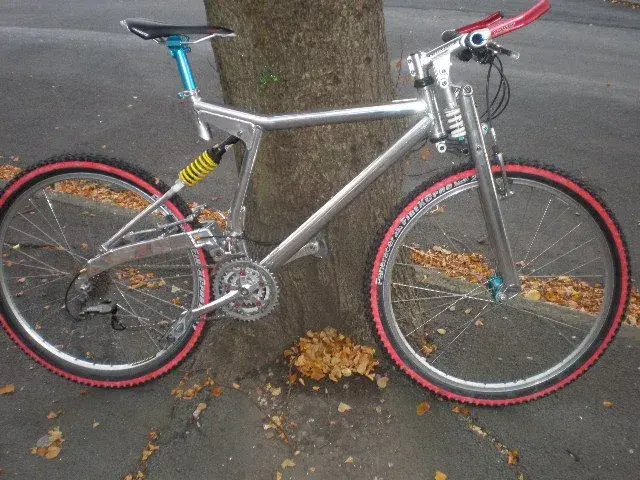

just to wet your apitite on the polishing heres a 955 i polished and parts sourced for a local rider. :D hope these pics do it justice :wink:
Good job the sun wasn't out for those pics! 8)
Love how the ano bits are now so much more emphasised.
Awful pic of the grey XTR against the translucent blue, didn't have time to spin it around out of silhouette, sorry! Think it could work well...
Also please note the presence of a mech hanger, thanks very much! :D
Have some cantis on their way and an offer on some nice levers (that'll want a polish :wink: )...
I've pulled the shock out for a look at the bushes and to swap the conical seat back in in place of the temporary (but excellent fit!) headset top cap and I have a feeling there's no oil in it :cry: not sure yet if these are serviceable, need to spend some time on the Proflex forums!
It's also now very wobbly as the shock sits flush against the seatstay but there's a big powder run there, so I'll have to rub that back flat.
