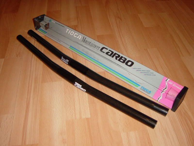

I picked up some bits at a very nice price from ‘Steelboy’ :
Never seen this type of grip before, not sure if I am going to use them but as the end caps are rubber they will do a great job of protecting the carbon bars. Any comments ? :

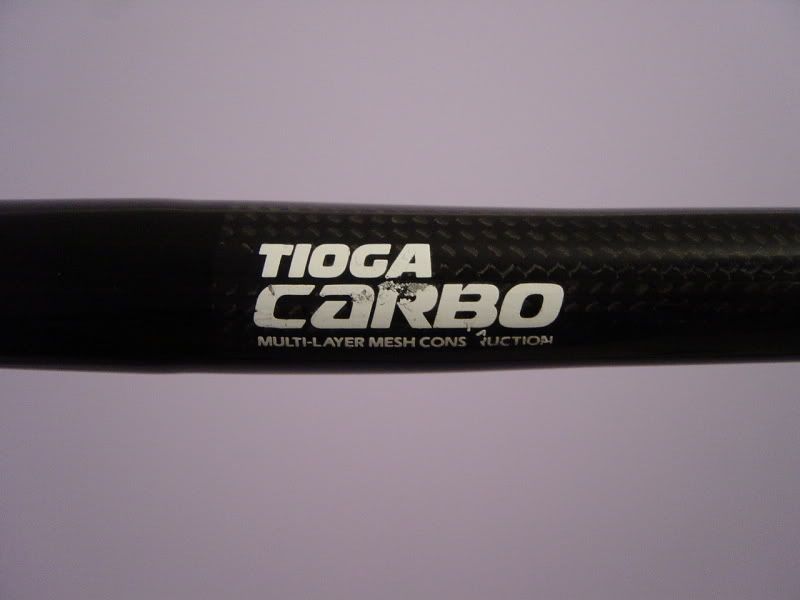

The set of bars with the intact logo will be kept as NOS / spares, The set with the damaged logo (which are still NOS) have had the logo removed / polished and will be fitted on the ProFlex :-)

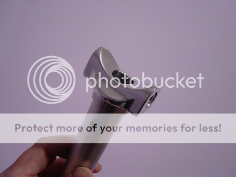

The only thing I have done recently (due to Christmas / work / blah, blah, blah etc) is to polish the bottom of the steerer :
I am not having much polished stuff on this build and wanted to have this powder coated but on close inspection its bonded on and I was worried about the heat from the ovens weakening the joint :-( It came up better than expected due to it’s shape and it being a casting rather than a billet / cnc part 8)
