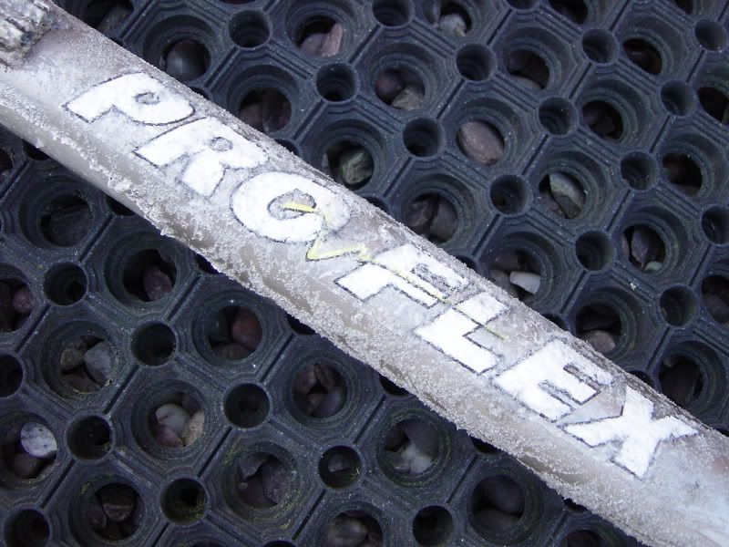

Ever seen a ProFlex with a crackle paint finish ? :
Strangely enough for such a crap standard paint job (have a look under the seat gussets – they forgot to paint under there on mine and it was bare ally !) the paint stripper actually struggled with it :shock:

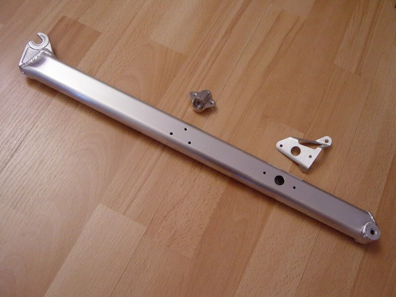

I am pleased to say that the frame underneath looks to be in very good condition and only has the smallest of dings in the top tube (you couldn’t see this when it was painted, only when it was stripped and flatted off). There is no corrosion, cracks or anything else to worry about, not bad for a freebie … 8) I will post some pics when it is fully prepped as I am still rounding off a few sharp edges etc getting it ready for powder.

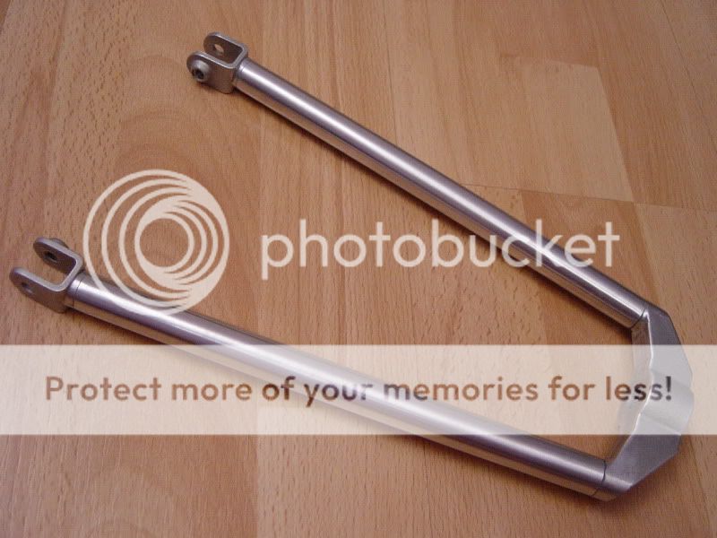

Some of the other bits have been cleaned up and came up really quite well. The seat stay bridge :

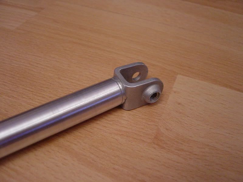

It’s a bonded construction with cast ends. I was quite surprised by the quality / design of some of the bits – stainless steel threaded inserts :

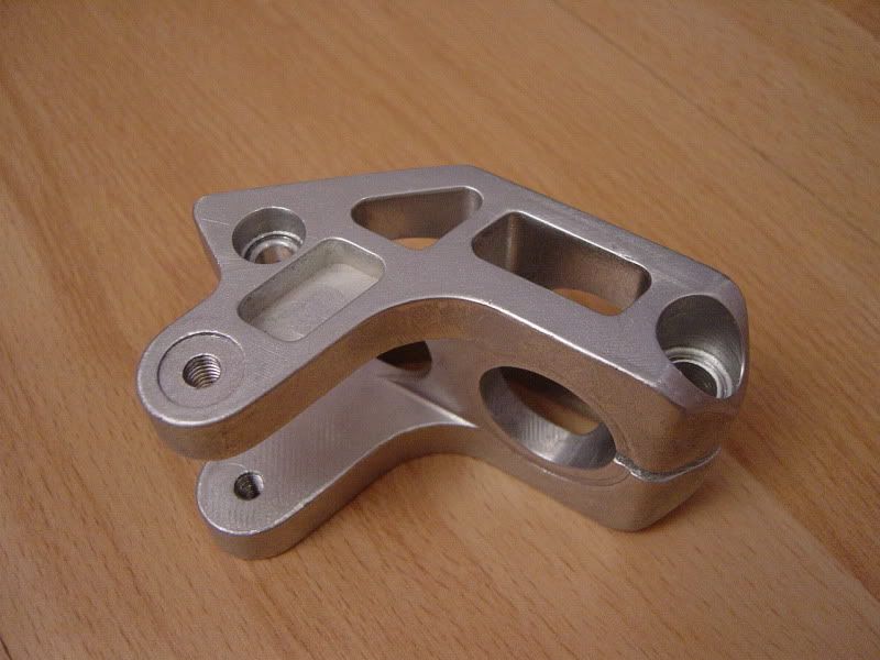

I have cleaned the top front damper mount up :
But I am not sure how I should finish this – powder coat to match the frame or to match the swing arm ?

Anyway, match the forks to the swingarm - gives a nice balanced look front & rear (which is hopefully what you'll get shock-wise!)

I am going for black with the front damper top mount but will need to speak to Windridge to see if it will look good once done due to it's complex shape :?
