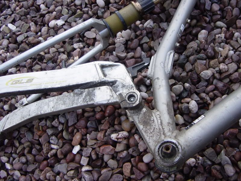

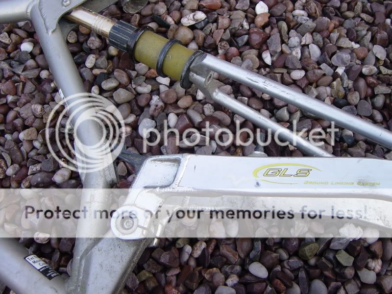

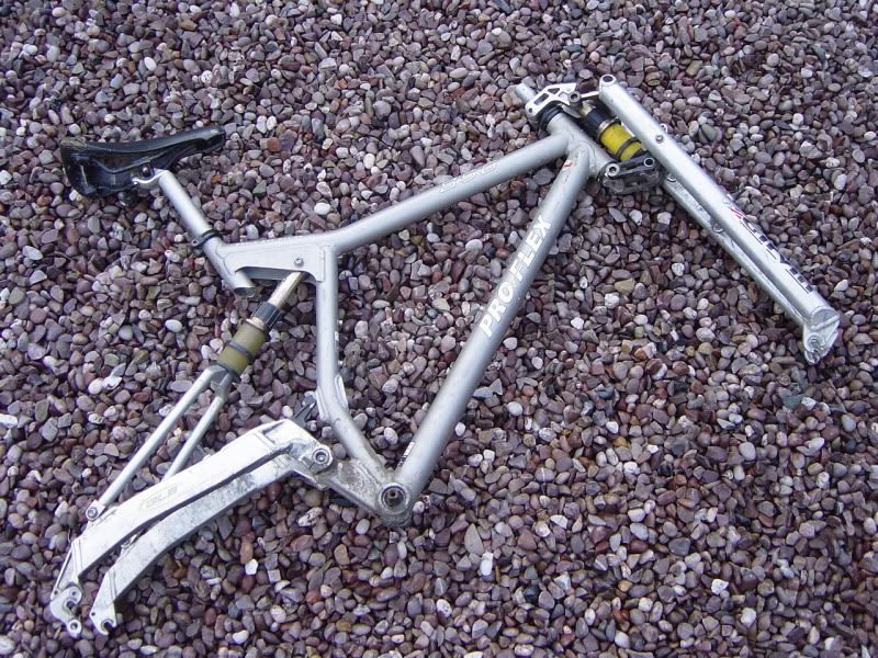

OK, got all the pics uploaded so here they are :

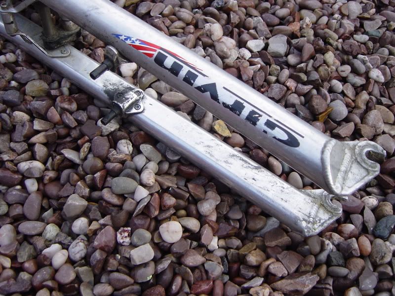

Are those defo vectors then as they are different to other I have seen around the stem area ? :?
WD :D
Yes, those are definately Vectors. Mine are the same with carbon legs.
One certain way to know is that vectors came with the canti hanger, and crosslinks did not. Depending on the shock, you will get about 2 to 2.5 inches travel from the fork. The ODS shock is oil damped, and usually 30 weight is inside. I prefer about 10 weight.

Nice bike 8)
Thanks for the link to (RD) I have signed up and shown interest in a pair of springs, also found out the forks are a 'vector 2 (new)' acording to the descriptions on there :D What stems were fitted to these bikes when new ? cant decide on keeping it OE (ish :wink: ) or full on modern ...

The Vector 1 it's own stem with the shock mounts welded on it. I hate those. So I think Vector 2 had whatever they could get, and did not have to be special made. There were some girvin branded ones at the time.

Now the pics are up could one of you kind PF experts give me the correct part numbers for the rebuild kits ? I want to do a full bikes worth i.e. Vector 2, main swing arm pivot and the damper brace to swing arm pivots. Could also do with a set of concaved washers for mounting both the front and rear shock tops.
The picture of the kit listed above seems to be the complete frame set but what about the fork and damper mounts ?

Looks good. I can confirm that RDS springs are good, better than the origional elastomers by a fair bit. My 856 is still going strong and is still used around 3 times a week the now.
Resident ProFlex experts - Am I right in thinking that to completely rebuild this I need a RK002, 5 & 6 kit ?
