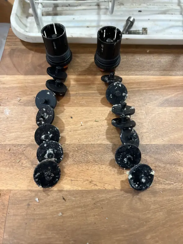

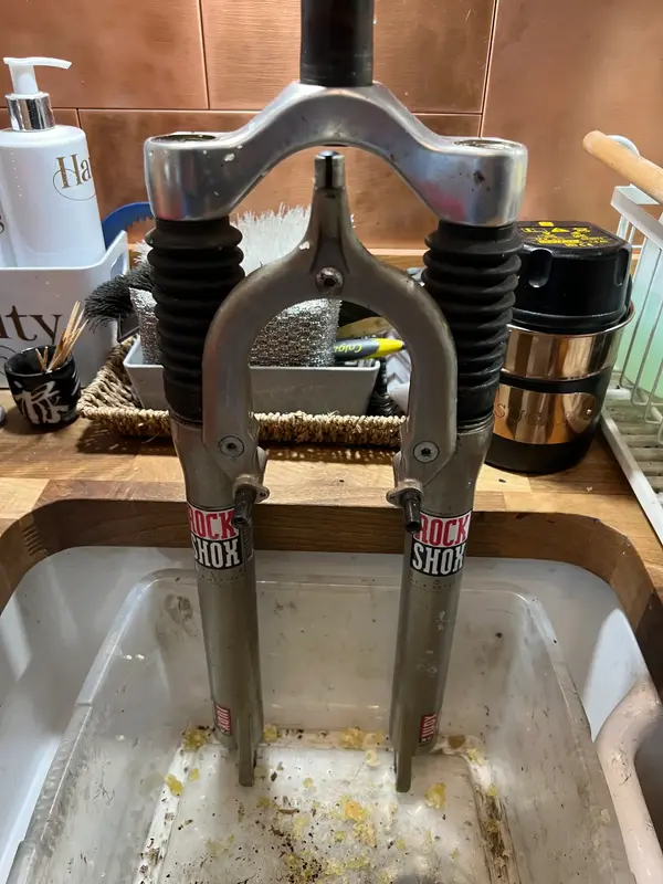

Currently servicing a set of RockShox Judy XCs.

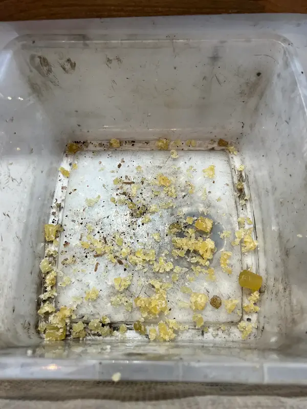

The MCU stacks have entirely disintegrated. I’ve removed what I can but the remains are really sticky.
Can anyone recommend a product that would eat through the stickiness?
Not quite sure how I’m going to clean the inside of the upper tubes, perhaps a rag soaked in product on a stick?

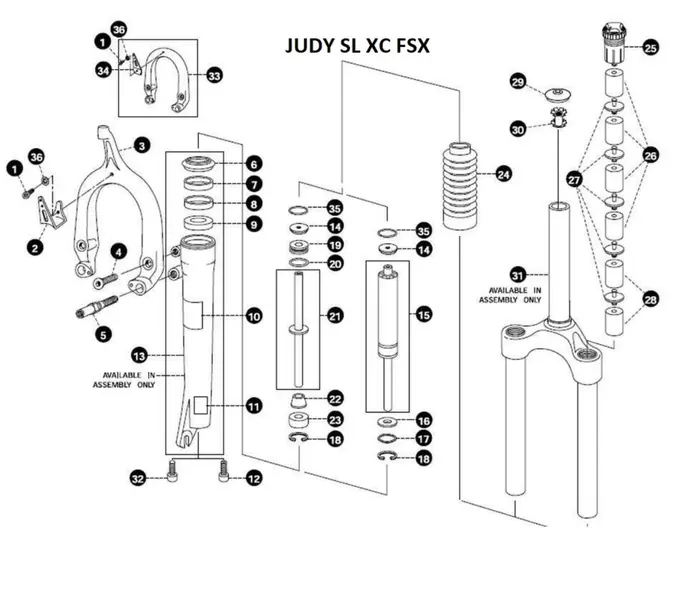

As I was cleaning them out the Judy Jax just kept coming! 7 from each leg! Service guide suggests there should only be 5!

The condition of the elastomers you show there is pretty good still! they just crumbled. Be happy ...
