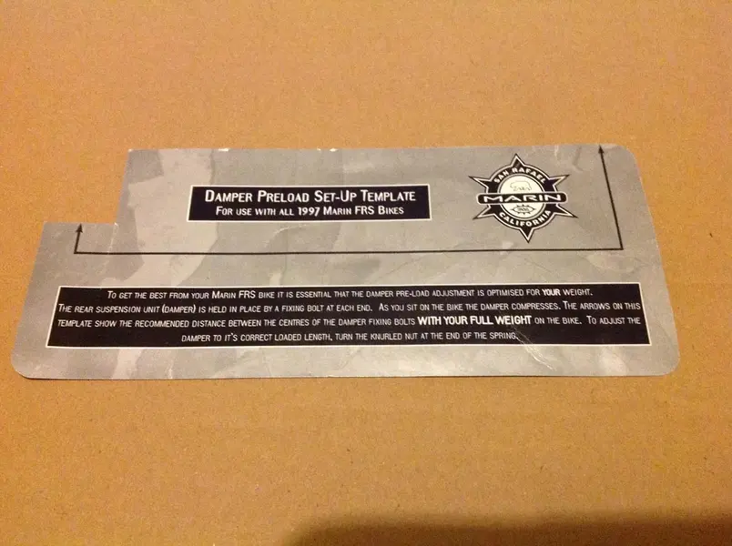

Possibly a strange request, but does anyone have to hand, the card template you got with a late 90's marin FRS, Rift Zone, Mount Vision or the like, i have one but cannot for the life of me find the damn thing (which is infuriating as nobody claims to have moved it from where it was) but anyway...
The bit I'm after is a measurement between the two markings on the card so i can use it to mock up a stand in and set up my mates rear shock, and try to set up my new air shock when it lands (assuming that the sag/preload amount should be the same using an air shock)

I've only just seen this, but I have one if I can find it. pretty sure I know where it is I will dig it out tonight if you still need it?
Cheers.
Hi
I found it, it is 155mm between the two lines, and 157mm arrow to arrow.
Hope that helps.
