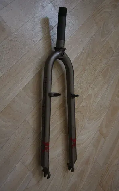

Is it theoretically possible to extend the steerer tube of my original threaded P2 fork, converting it to a threadless system? Would any joint be strong enough to withstand any relevant strain? Can it physically be done? Would it cost more than its worth?
I've had an idea of how it could be possible to physically do this, by cutting off the existing thread, cutting a thread inside of what's left and screwing an extender piece of tube into that. To add strength I was then entertaining the idea of carbon wrapping the resulting length of steerer, obvioulsy whilst maintaining the current external diameter (28.6mm). I have considered that this may require a little metal lathe action and got quite disheartened to realise that spinning a pair of off-centre forks on one of those bad-boys is not likely to appeal to many owners of said kit!
Obviously I have considered that extra weight may be a possible issue, lack of strength at joint, prohibitive expense or just plain old physically impossible to achieve the correct result...

It is possible but not worth the outlay IMO. There are plenty going around, its just a matter of patience. You will also be able to use a threaded pair with a suitably long steerer, you cut the threaded part off and use ahead style.

Did they make a P2 with a threaded steerer where the thread was cut above the 194ish mm line (measured from crown)?

Argos Cycles can cut the steerer, fit an internal sleeve, and braze on a threadless extension. This doesn't usually wreck the paint.
