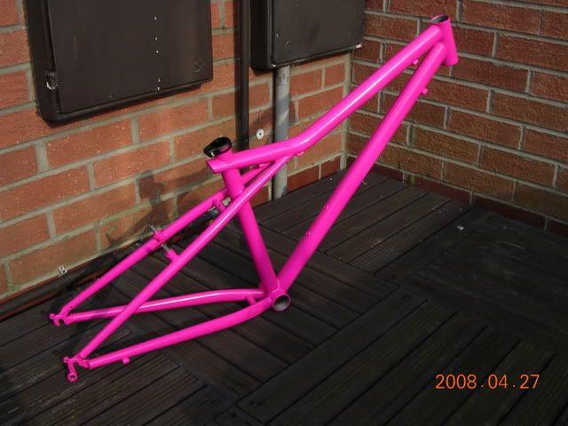

Colour has not come out well on picture- it is much more limey. A top job!
