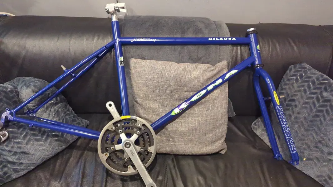

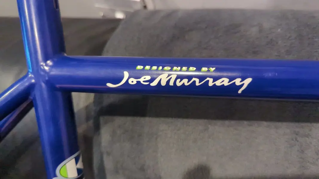

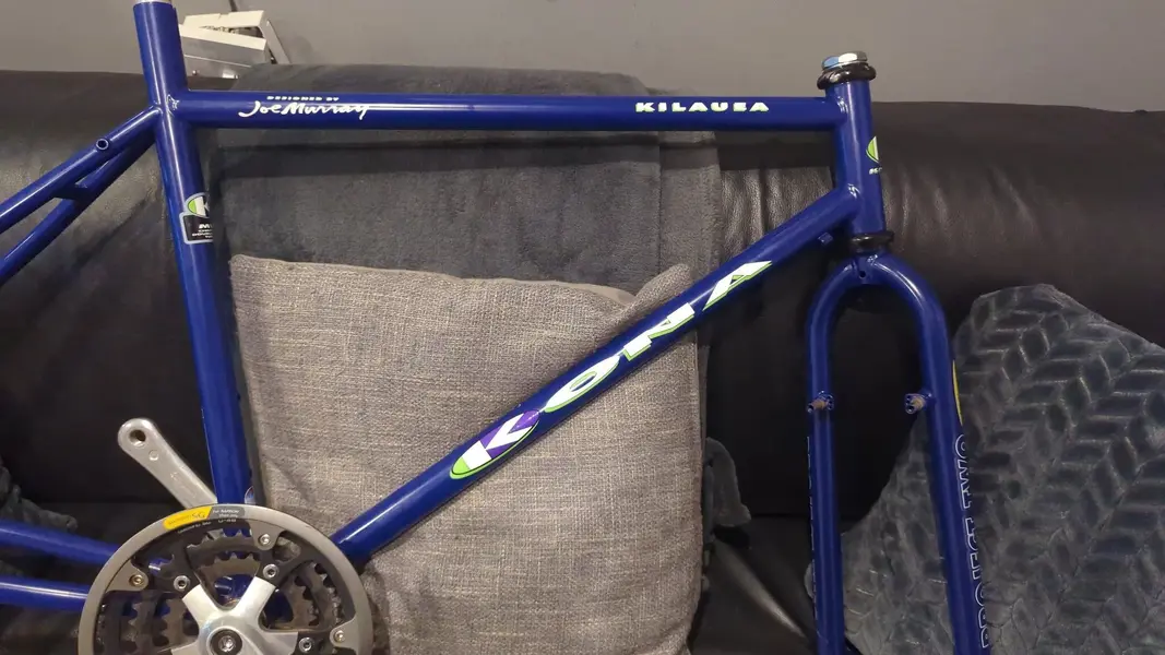

The frame is original colour and looks mint!
It's a great looking frame and fork, I can imagine the little 'Designed by Joe Murray' sticker being quite susceptible to peeling away if caught. Don't see many of the old Deore cranks with the chainguard still intact, quite rare. Good luck with the lacquer and post up some pictures when it's together.
