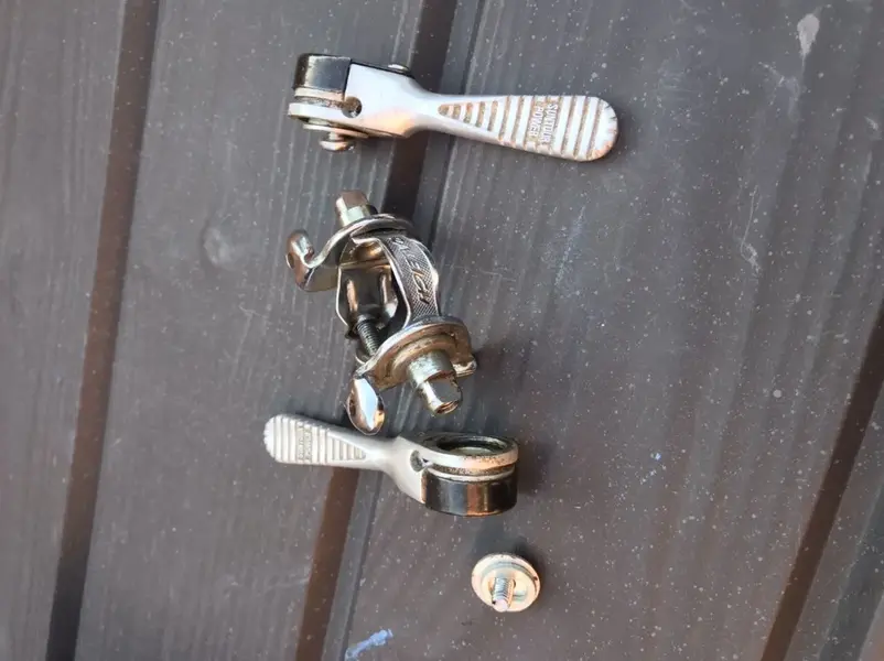

With regards to the down tube shifters... would something like this work?
I’ve had a little search for a band on sti cable stop but seems like they might be hard to find, sure there must be something out there..

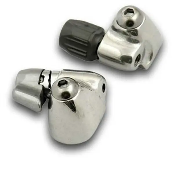

Yeah, that'll work, then just bolt the cable stops onto that. I think I've got a pair of exage 500 or Dura ace ones kicking about if you want them?
