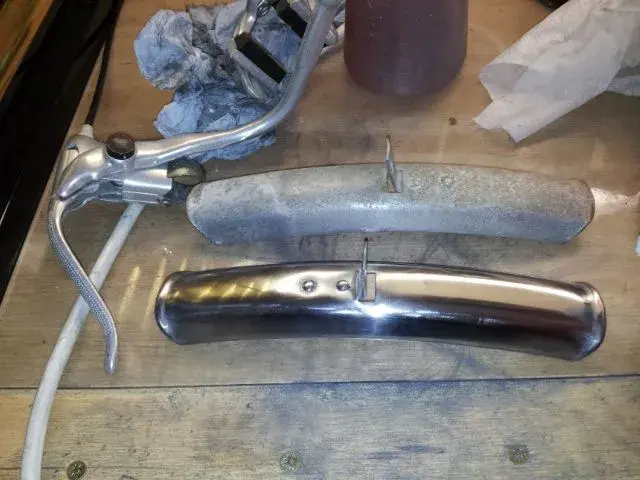

just spent 2 hours on a stubby mudgaurd!! from 120 through to 12000 grade wet svc dry finished off with a bit of auto chrome... above one is what it was like before!
Lovely work,
are you sure of the W+D grades?
One point, was there any rust on the chrome?
Richard
these are aluminium, pretty impressed with the outcome, not looking forward to the next one though!
yep, sure of the grades. I also questioned it but its called micromesh, a premium type of wet and dry, aquired from my mate who is a helicopter engineer. the 12000 just buffed it nicely, probably went backwards using the autochrome, gave a lovely shine though!
