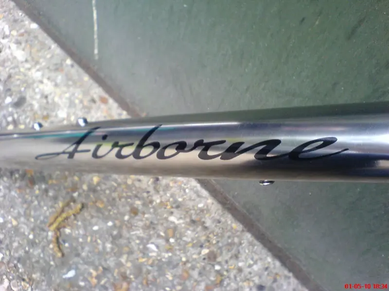

Take it to a proper metal polisher and he'll make it like a mirror for not too much money.
Professional job, with far less hassle and time.
See below for a job I did recently. Compare it with the NOS frame in the background.
Hi Benandemu,
I'm looking to get a titanium frame polished do you mind telling me who did your's and what it costs. I've had a go at it myself but it's taking to long and it's very difficult. The only local polisher i asked would not touch it, said he may damage it. Thanks for any help.
Eddie.
