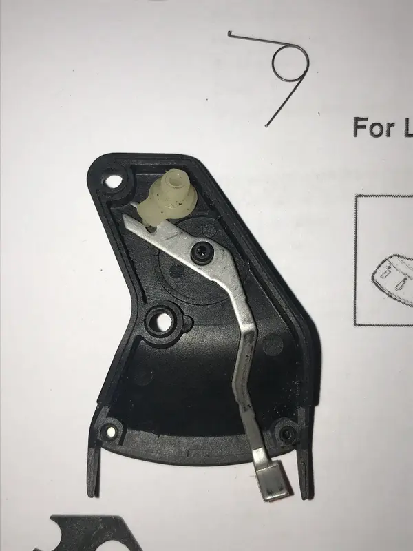

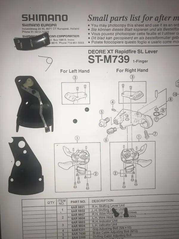

I disassembled a Shimano shifter ST-M39 because the speed indicator didn't work properly. Now I don't how to reassemble it! :facepalm:
Basically I don't know where the spring goes with the metal indicator.
I tried several position but I didn't find a solution.
Does anyone known how to do it?
Cheers

It goes over the black arm pivot to return the pointer.

If you are determined to fix it, often the spring needs a bit of a bend to make it go all the way.
