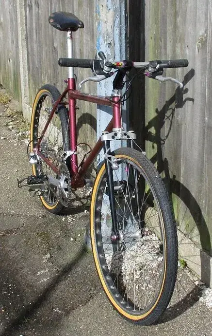

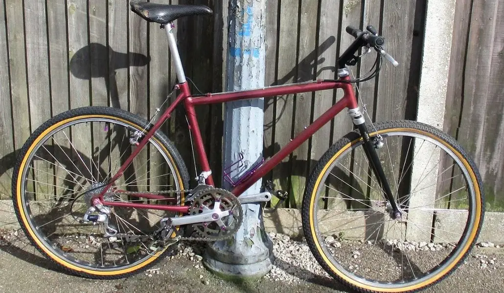

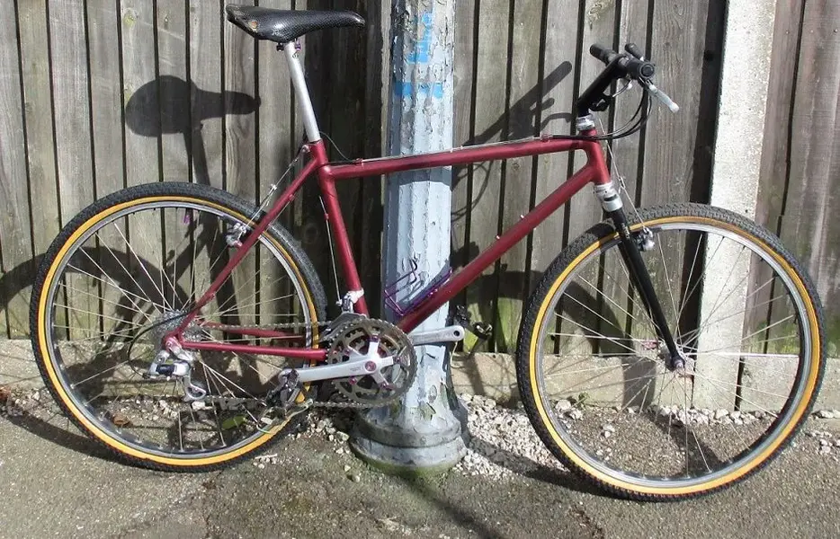

Hi Everyone
The lockdown has provided me with the impotus to actually finish this long term project :facepalm:
199- Overbury's Pioneer frame
Downsides, this has been badly molested by a previous owner canti mount removed, gear cable stops moved to top tube, think also may have had mudguard/rack eyes removed too, couple of small storage dimples.
Upsides, nice paint job with a red/gold flip.
At first I had the idea of fitting a Sachs Quarz/Neos/Centra gruppo but with the very short U.S.E. handlebars and gripshift it didn't look right.
So having managed to aquire a top pull XT front mech I descided to go with an XT/DX Group, with a few choice upgrades :D
With the frame colour I chose to go with some nice purple parts also helped by the fact the bars had a purple shim 8)
Frame: 199- Overbury's Pioneer 18.5" C-T
Fork: Tange Prestige Switchblade
Headset: Dia-compe
Stem: ITM with purple Bici stem bolt
Handlebar: U.S.E. 510mm
Grips: Titec
Barends: N/A
Brakes: Shimano XT 734
Brake Pads: Ritchey slim
Brake Cables: Yes
Cantilever cable hangers: Shimano
Brake Levers: Shimano DX with Venhill purple adjusters
Shifters:
Front Derailleur: Shimano XT top-pull
Rear Derailleur: Shimano XT Short cage
Derailleur Cables: Yes
Cassette: Silver, 11-26, 7 speed
Chain: PC 980
Cranks: Shimano DX
Crank Bolts: Middleburn purple self extractors
Chainrings: Middleburn hardcote 46/36/26
Chainring bolts: Middleburn purple
Bottom Bracket: Shimano UN52
Pedals: Wellgo, with Christophe grey clips and black straps
Hub Skewers: TEC purple
Rims: Alesa concave black anodised wideboys
Hubs: Shimano Deore II
Nipples: Brass
Spokes: Stainless
Tyres: Dai yung amberwall
Tubes: Inflated
Saddle: Selle Italia Regal Gimondi perforated kangaroo leather
Seatpost: U.S.E. silver with purple clamp parts
Seatpost Binder: Venhill Ti purple
Weight: Don't be so personal

Re: Pioneer Rescuration
Now, that looks really nice, especially the paint 8)
Whats the story behind the paint? i assume it was done when the frame surgery was?
Yes I think it was, all I know is it is Red metallic layered over Gold gives a sort of Bronzy colour I do have some spare paint which was supplied with the frame. The mods have been done okay but used 2 different stops :facepalm:
Depends on the paint surely.
Only I am allowed to call you surely.
kermitgreenkona88":3g5st2y0 said:
Asking opinions on decal/sticker colour :wink:
White or signal yellow would be my choice. Lovely build by the way and I don't think the mods have detracted from the frame 8)
