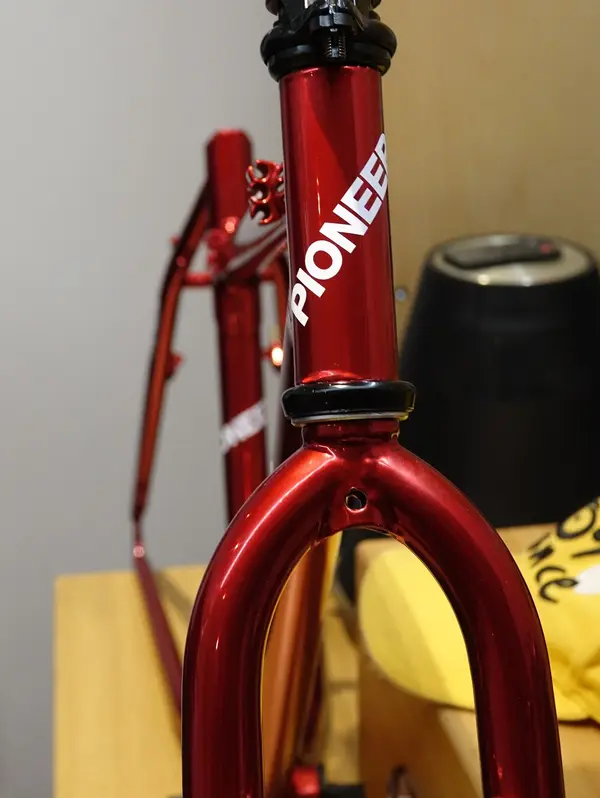

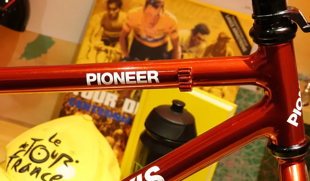

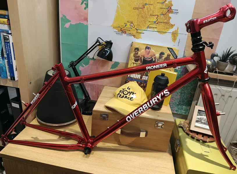

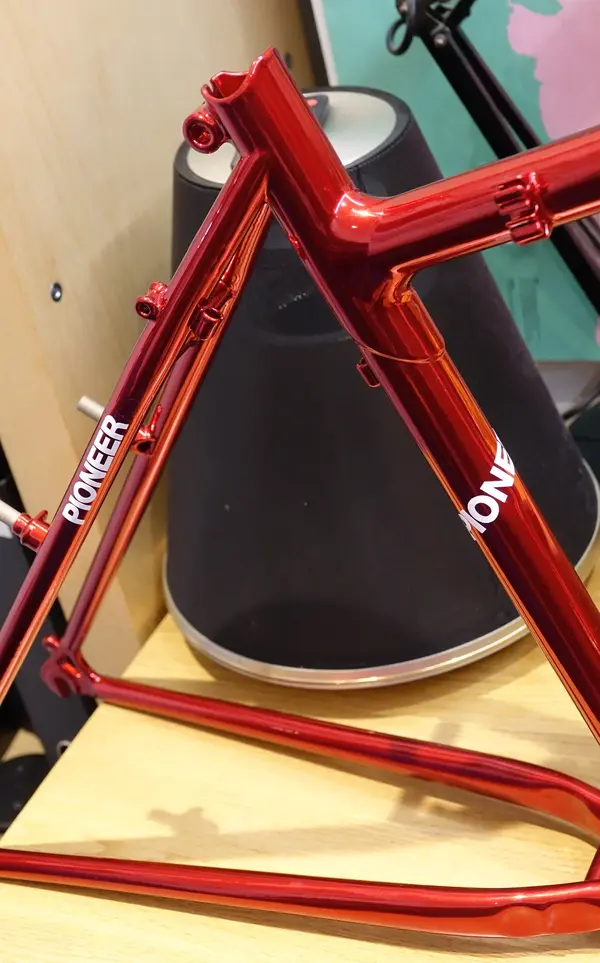

starting a build thread for this curiosity:

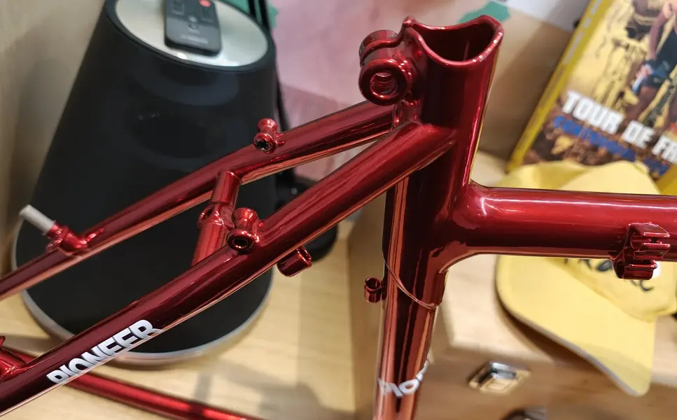

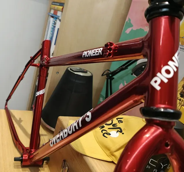

I bought this frame from a forum member before xmas in Somerset - who in turn bought it from another forum member , I decided to build this one up as a restomod and went for a loud colour atypical of Overbury's bikes - its now back from being dipped and powder coated and is looking pretty neat.

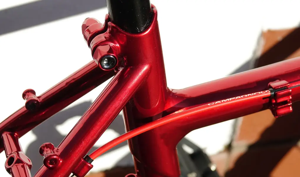

I am puzzled by this one - it has v-brake style cable routing, no canti bridge and routing for top pull front mech - all of which are not your typical Pioneer build - I have 2 others and have compared closely... ...The fillet brazed parts look exactly like my other pioneers as does the BB shell and the dropouts - very puzzling, its possible this was a one off experiment but I have not seen a Pioneer later than 1992 and V brakes came on the scene in 1996.
(fwiw the fork is from another source - I just had the 2 powder coated at the same time and it looks simialr to the unicrown forks of early 90s)
back to the frame - I guess the triple cable stops could have been added later but that doesnt explain the lack of a canti bridge. Or it could be something else altogether - but the closeness to the Pioneer in so many ways is baffling - right down to the shaping of the top of the seat tube and the lugs on the BB shell, plus derailleur hanger are all standard Pioneer.
From the weight and the gauge of the tubes it appears to be a mix of reynolds and columbus - which is not unusual for a Pioneer, it also has all the other trademark Overbury's traits like 1" Head tube and seat tube is similarly thin , not at all like a mid 90s bike that would almost certainly be 1 1/8 head tube and thicker seat tube too.

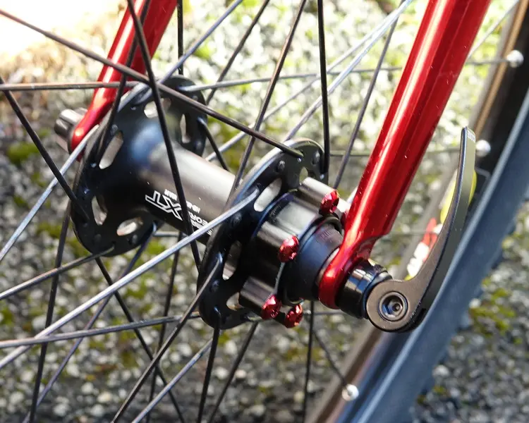

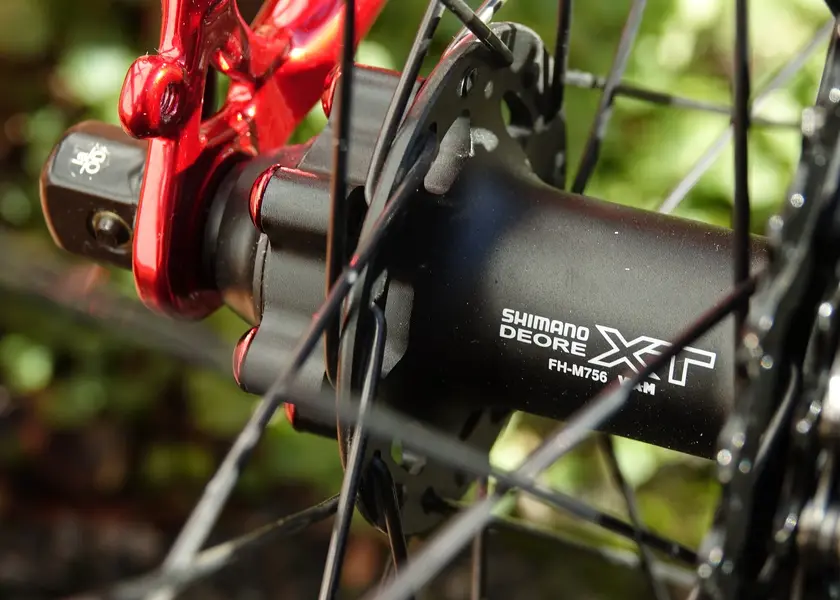

I am not overly bothered it will build into something nice - I have some NOS XT hubs and rims and will add a 1x9 drivetrain - once I assemble the requisite parts. More anon
Hiding an interesting past maybe? Is there a serial number under the bottom bracket?
no serial on the BB, but I have had 4 Overburys bikes without serial numbers and 1 of them I picked up new from the shop , so I know that Mr Powell was so under the cosh from Enid, he never had the time for such frivolities ;-) I do agree this could have had an interesting past, e.g. part built frame, discarded and then retrospectively had 'modern' cable routing applied.
Candy red
Is it candy over silver?
"Candy red"yes it's a two coat process iirc, I know it doesn't need a clear layer on top. Some of the candy colours can look a bit 'fairground' in the wrong setting, I have tried candy purple, candy green as well, they aren't too OTT on quality frames, but I wouldn't do my car wheels or a wheelchair with any of those !

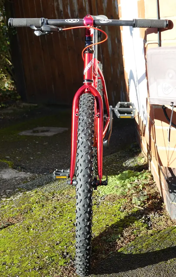

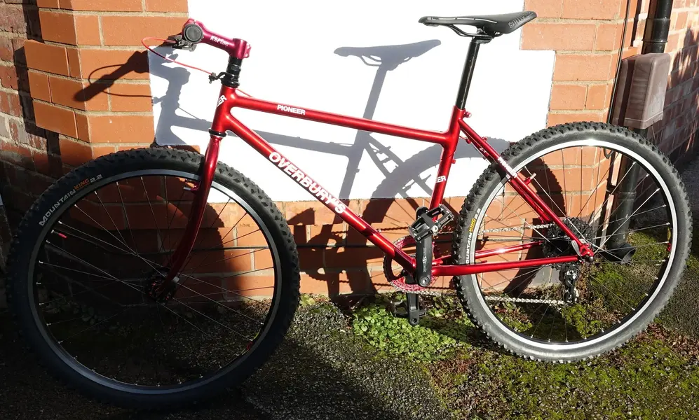

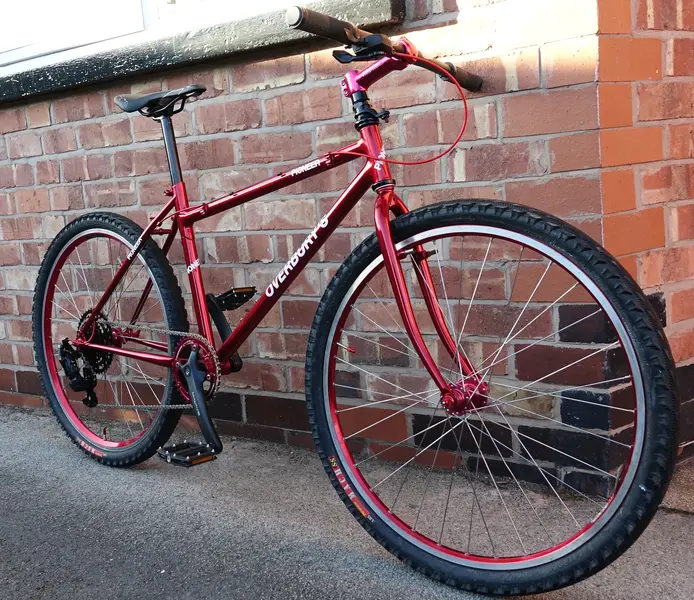

WIP , partial build while I wait for brakes from Spain , Cranks from UK and levers from elsewhere in Europe...
... I had earmarked some red hope hubs and rims with red wall tyres and red crankset but having built this up with black bits from my parts bin I am liking the black on red effect - and the black XT large flange hubs seem to suit the skinny frame. I am trying to keep the weight down too , so I think the Hope wheels will be much heavier - will build with both colour schemes and see if all red is a bit OTT.

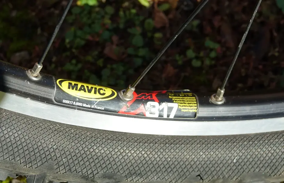

DSC07598_cr.jpg DSC07599_cr.jpg DSC07600_cr.jpg DSC07601_cr.jpg DSC07604_cr.jpg DSC07605_cr.jpg DSC07606_cr.jpg DSC07607_cr.jpg DSC07608_cr.jpg DSC07609_cr.jpg

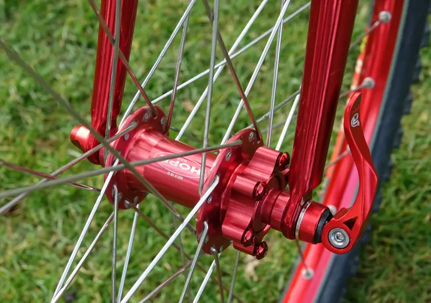

put the full bling wheels on for comparison, this was my original intent, just didn't know if it is too much red, the red cranks havent arrived yet either.
DSC07611_cr.webp DSC07612_cr.webp DSC07613_cr.webp DSC07614_cr.webp DSC07620_cr.webp

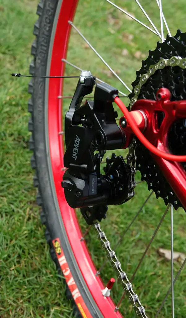

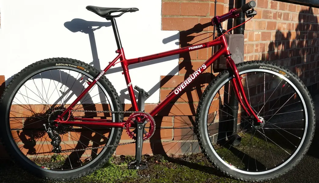

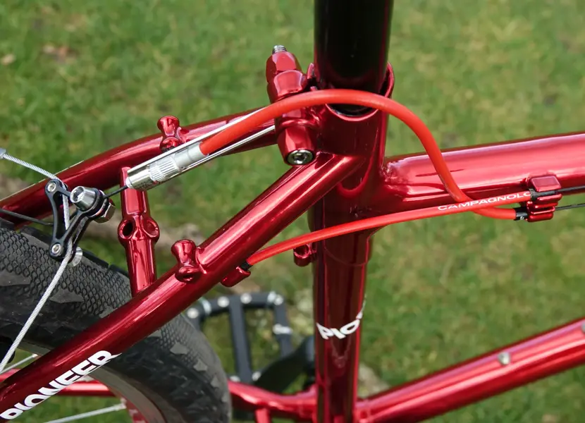

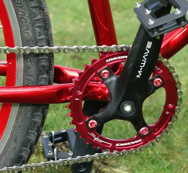

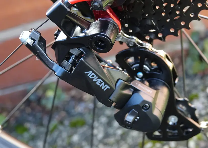

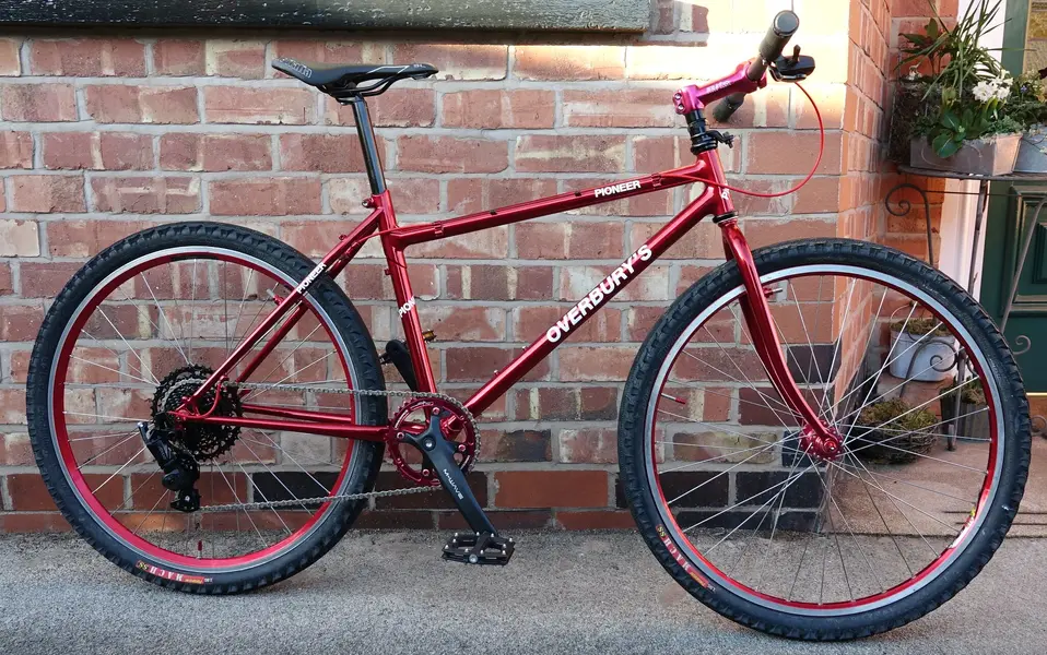

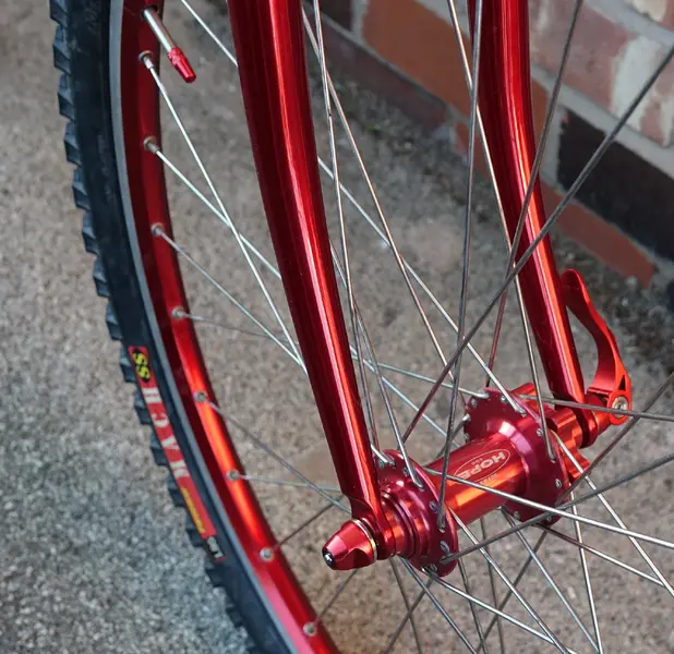

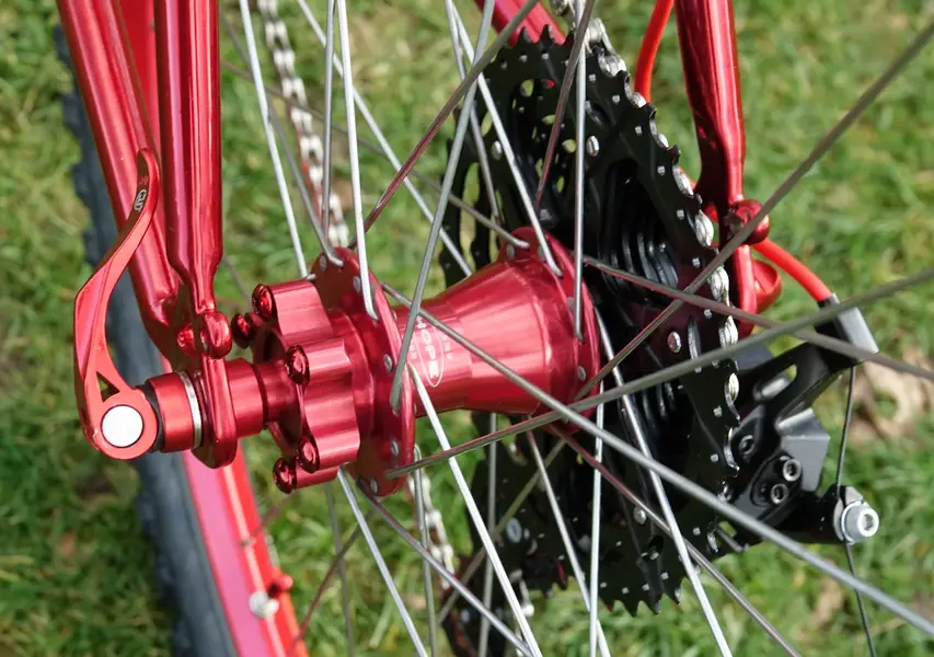

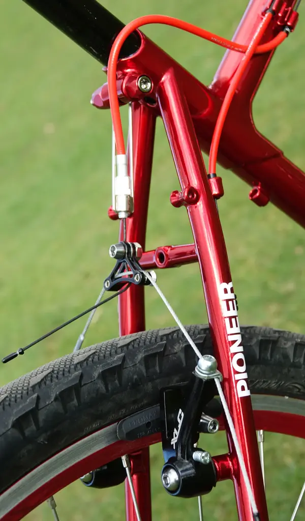

This turned into a 1x9 restomod with sharp braking and smooth shifting , zero chainslap due to clutch enabled rear mech and some rather nice original Hope XC hubs and super bling red rims :-) The Microshift advent drivetrain works seamlessly with the raceface narrow/wide chainring and the 2 finger levers and advent shifter are very light touch and positive. Modern cantis are nothing like period retro items and stop the bike properly and with good moderation. It helps having the infinitely adjustable cable hangers from CX outfit Kidsracing and the rather nice adjustable Surly rear hanger. Low friction campagnolo cables and teflon coated inners make for smooth cable runs.
