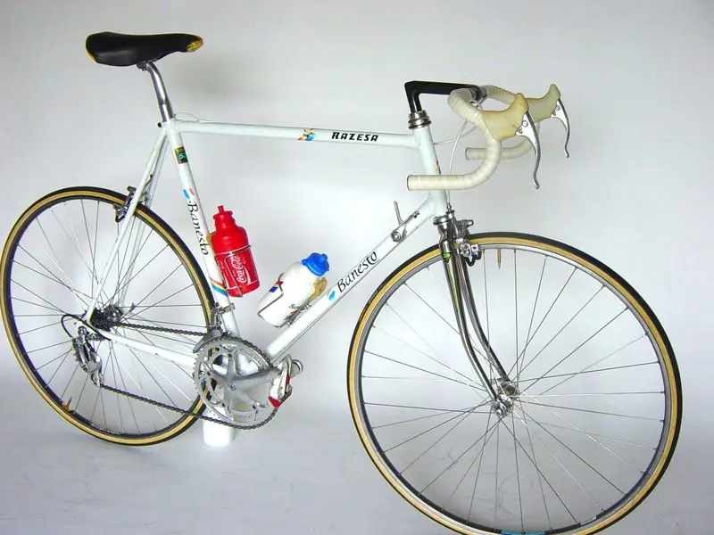

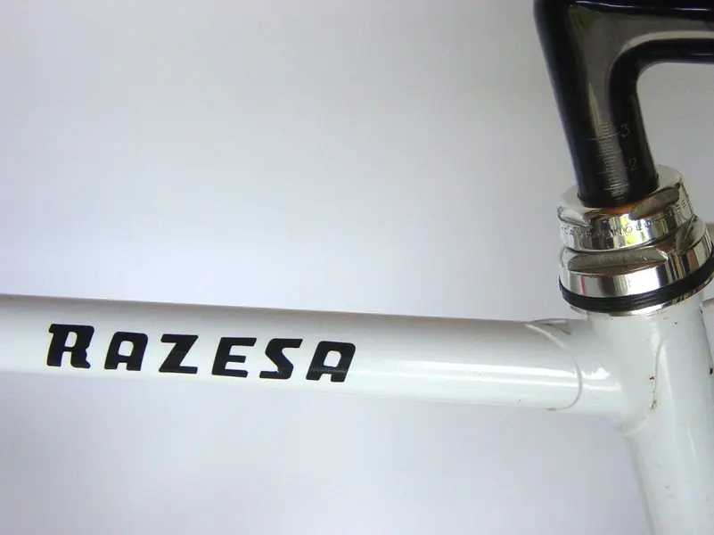

I've got a Razesa up in my loft, which I'm thinking of repainting as a Banesto indurain replica. It's a deep purple at the moment, but the paint has suffered over the years. Chrome still good though. Will paint it up like this:
