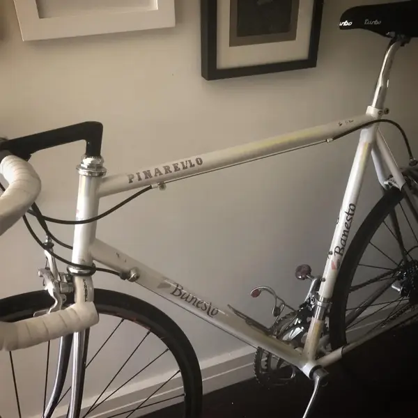

Hey there @dadoflam

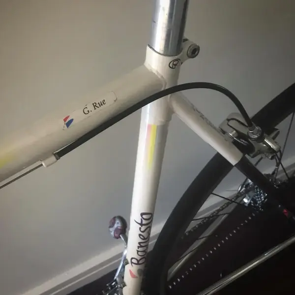

Looks like I picked up the Gerard Rué bike from the ‘94 tour. Officially team members but #8 here
🍻 870DB091-5909-45ED-8C7B-ED30F48F1080.jpeg BC0165AF-BD3F-4BE2-8A4F-A12A96A7665C.jpeg 963031CE-40C2-475E-B3D9-17517A2FFABB.jpeg
Brilliant - the 1994 season bikes were the only year with the chrome band where the FD clamps on to my knowledge so yes, definitely fits the bill. Well done.

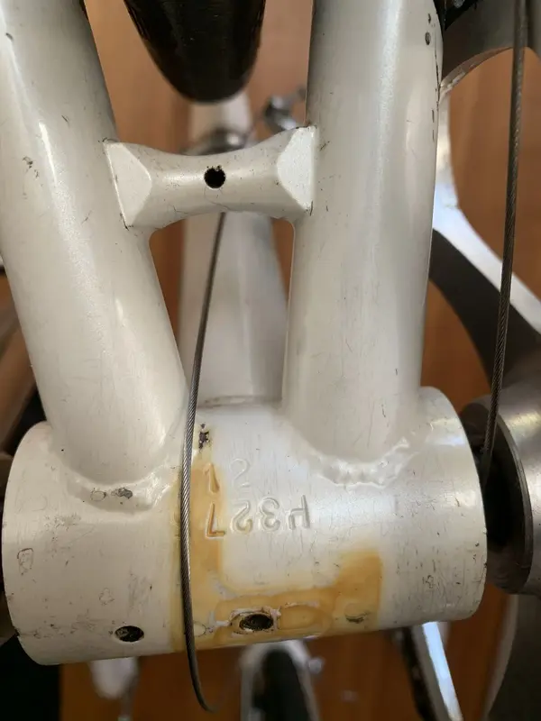

I have taken a photo of the serial number but not sent to Pinarello for verification -see attached to add to your data

Thanks for the BB number - out of interest, is there a prefix letter in front of the 12, under the cable?

Just had a look again but no prefix in front of the 12. Would love to see the Telekom ‘97 tho
