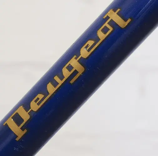

Blue & yellow lugs sounds 100% to me. I now wish that I had done my 2nd one in its original colours of Blue & Yellow.
NB the decals are different on the Blue/Yellow one so you need to talk to Greg at http://cyclomondo.net/page38.htm as I know he has them as I sorted it all out with him before I went with the WHITE again.
Also you need the French Reynolds decals.
The Peugeot on the down tube is in a script rather than block typeface.
I'm glad its of some help to you, the best advice I can give you is just take your time.
