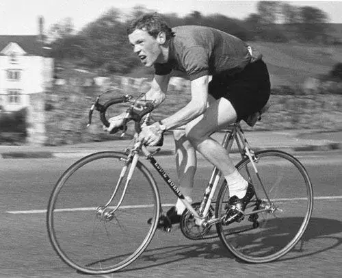

Regarding barend levers, the main ones in use were Campagnolo but Simplex also made a version (and possibly Huret?). You can still find them at cycle jumbles and I might have at least one in my 'stock'. Barends were popular with road racing lads at the time, I used them as in my avatar photo from 1965.
Here is a photo of me on my Eddie Soens in 1967.
It only seems like yesterday........................... :?
